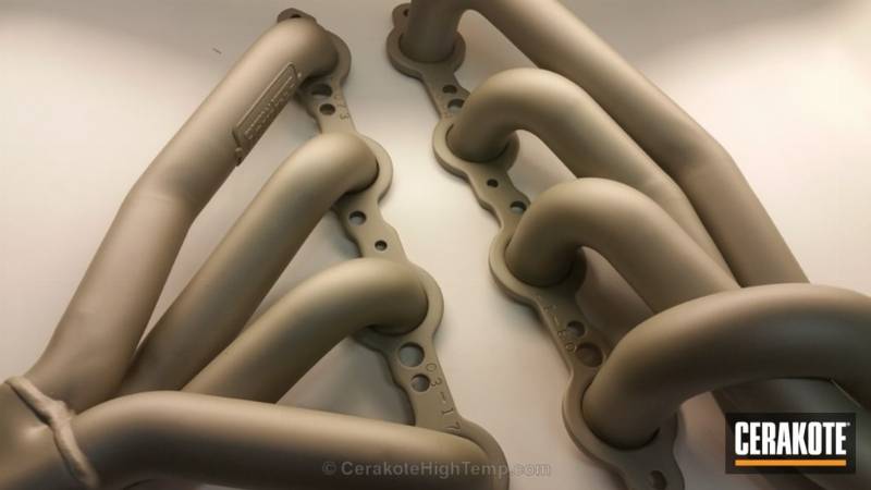

I'm looking for a set of manifolds for the 426 hemi but until then I will have to go with the headers that I have.
I want them to look better than they currently do and I don't think the high temp paint really works too well.
Has anyone on the forum ever used Cerakote to coat their headers?
I'm thinking about trying the Glacier Titanium C-7900 Cerakote on them but wanted to see if anyone has tried it and how well it worked and the durability of it.
Thanks, JKent

Cerakote makes an air-dry paintable high heat ( 1800* ) ceramic coating that you spray on with a paint gun. Tachs up in about 45 minutes and cures in 24 hours. They also make the bake-on coatings but I was going to use the air dry because I don't have an oven big enough for long tube headers. I would have to build a pretty big custom oven for something that big. Cerakote says that the air dry is just as durable as the bake on. It's called the Glacier series.
They have multiple different colors as well.
