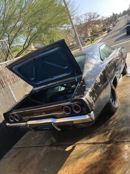

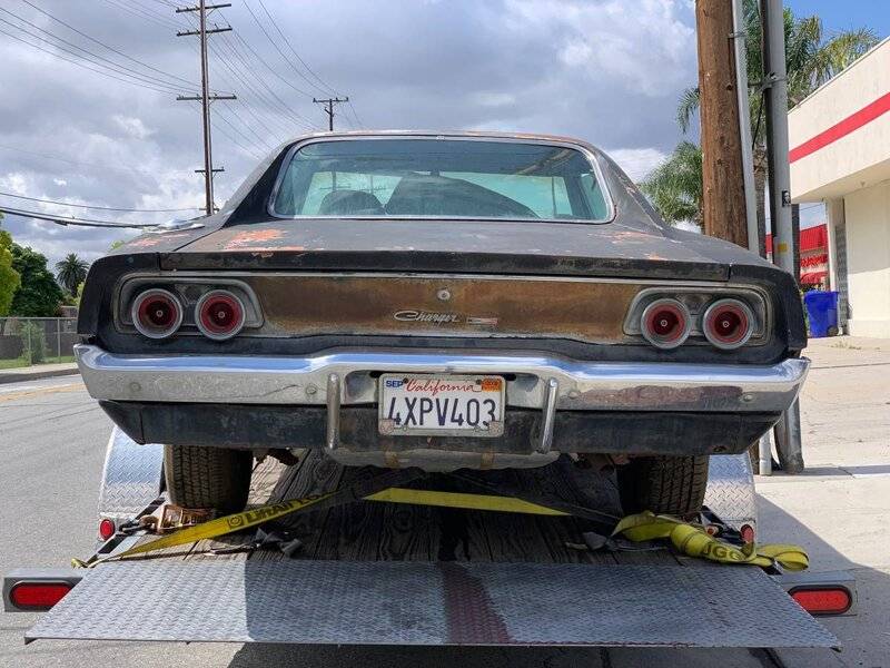

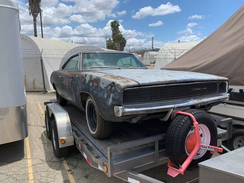

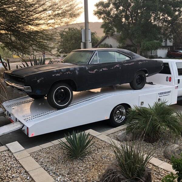

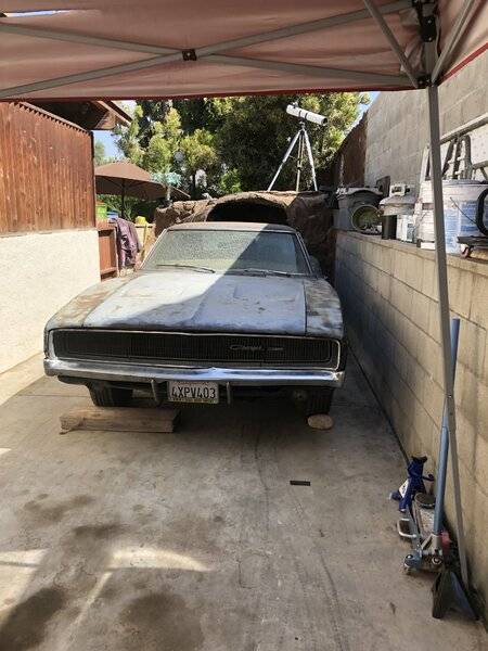

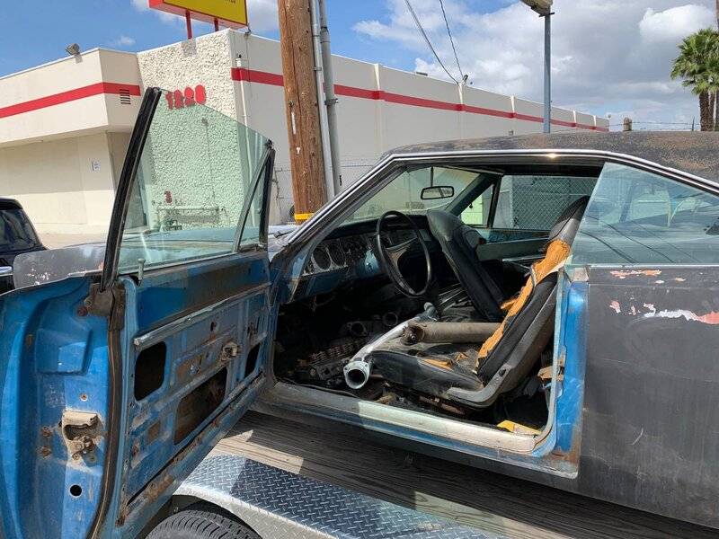

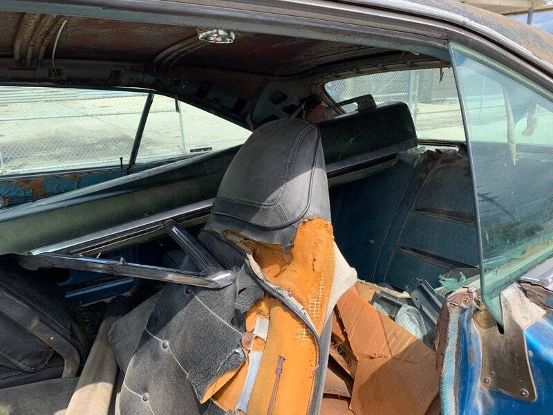

Here’s my first classic mopar and dream ride a 1968 Dodge Charger, originally a 383 Auto on the column, AC car. When I purchased it the 383 was long gone and someone had tossed in a late 70s 440. Sharing my experience during the project with the tear down and soon more install progress after the prep for it is completed.

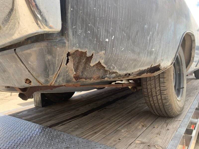

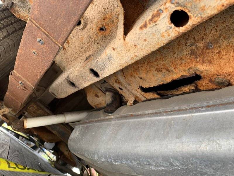

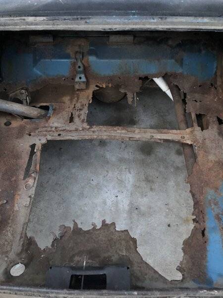

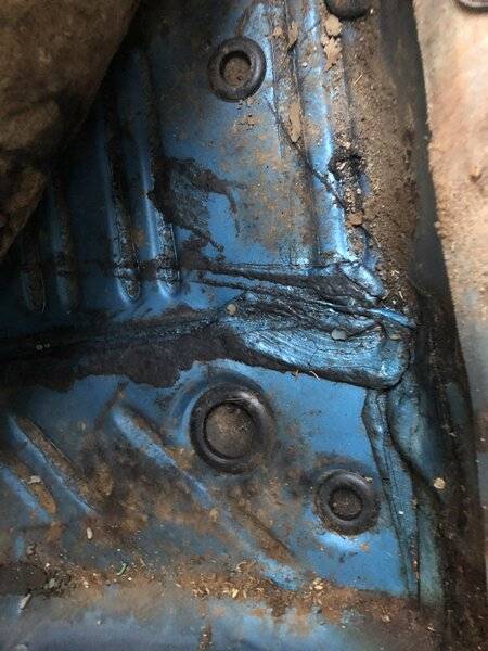

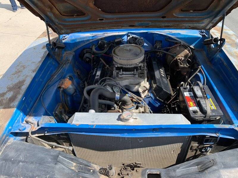

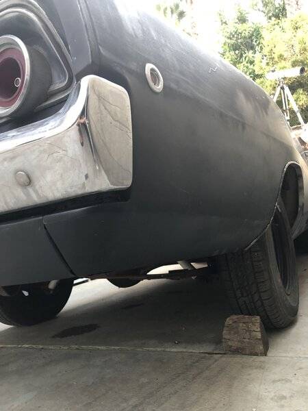

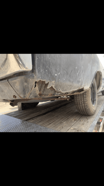

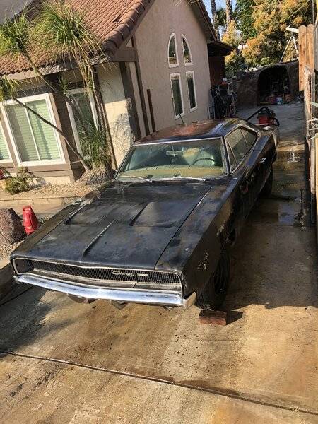

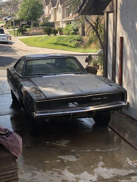

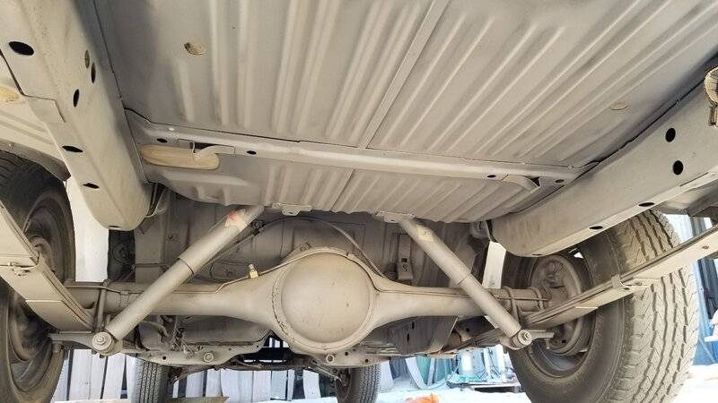

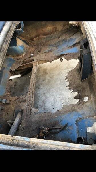

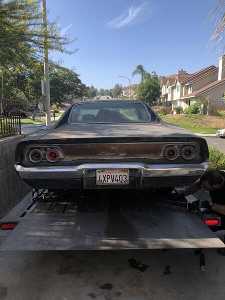

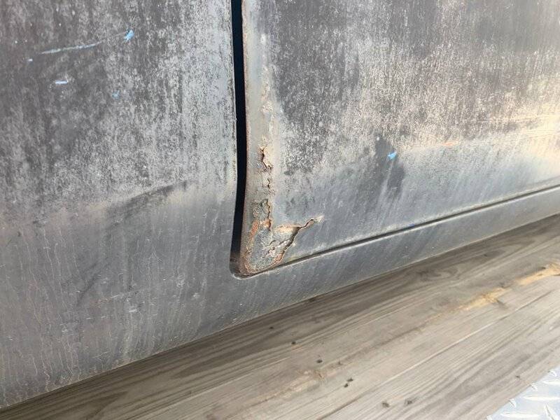

Thanks for the friendly welcome everyone! I appreciate the kind words, very excited about the project and already a little over a year into it so I’ll be posting more progress I’ve made in that time. Here are some more photos of the car as I finally starting tearing into it. The car spent most of its life in CA so the rust wasn’t as bad as others I’ve seen but not saying this one was free of it. The typical trunk/deck filler panel issues and lower rear quarters

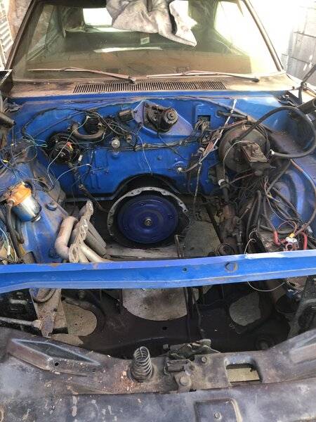

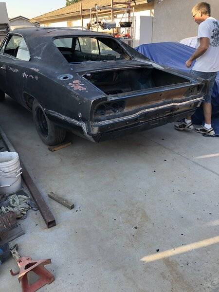

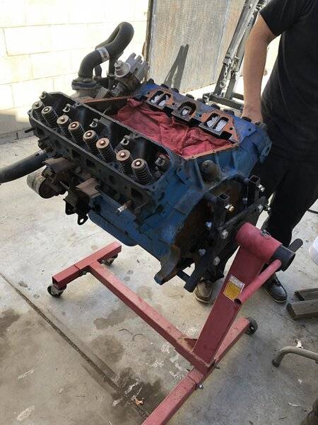

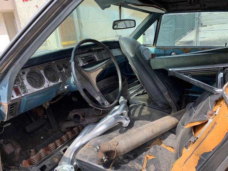

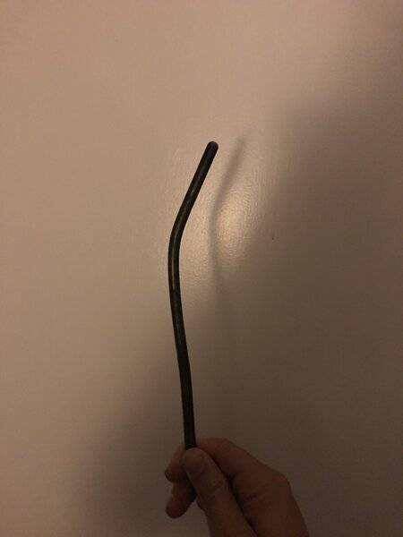

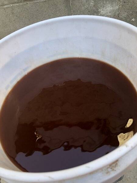

Next up got the car tore apart further, majority of interior removed. Pulled the gas tank out, drained the rusty gas out to find a bunch of rust chunks inside it. My friend and I got the hood off & yanked out the ‘76 440 in the car. Broke lifter and bent push rod found in it. Cleaned the ride off to see how it looked, really enjoy the cars patina.

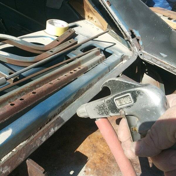

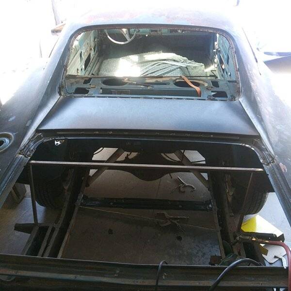

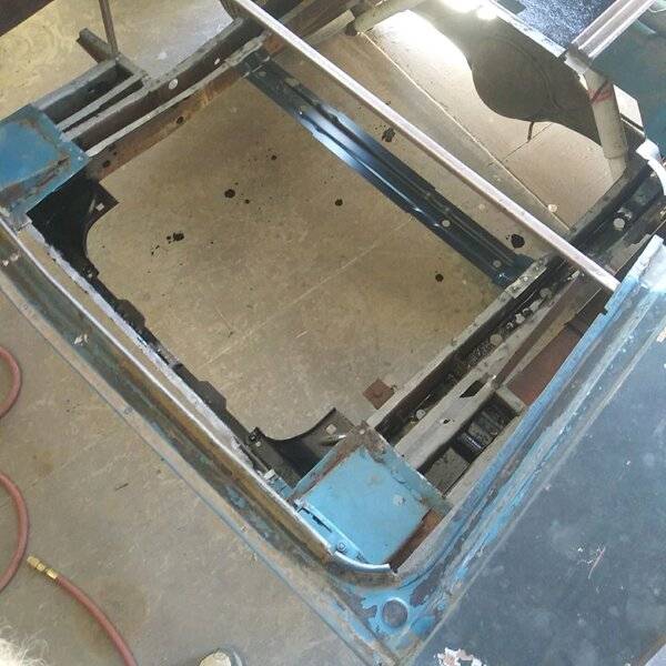

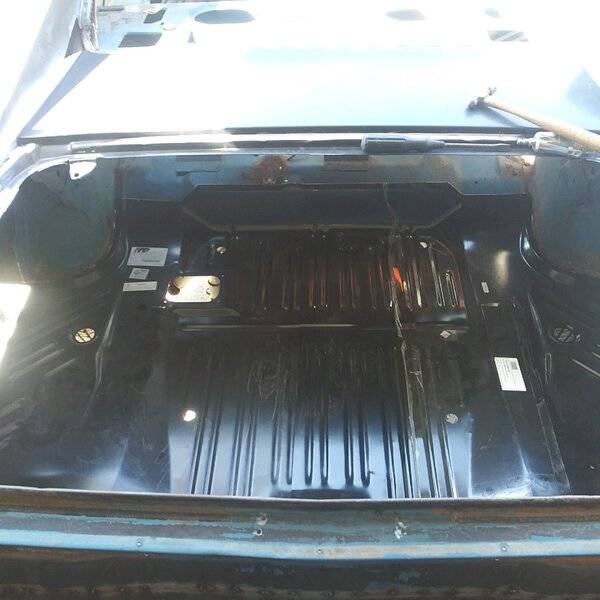

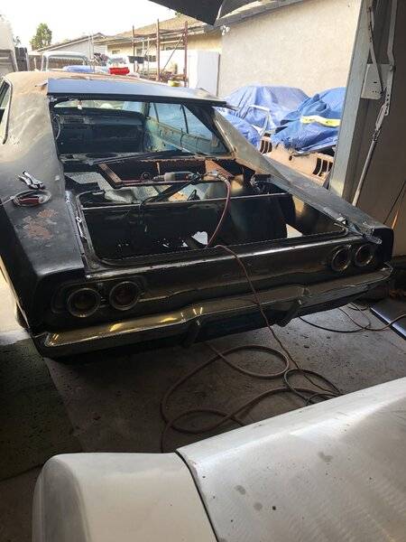

After getting the car apart I sent it to a local friend to knock out the rust repair/metal work needed in the trunk/rear of the car. New AMD metal included, 2 piece trunk floor, Trunk support bar, front tank hangers, both trunk extensions, both lower quarter patches, deck filler panel, lower rear valance & both corners. Some patches made in the sails around the rear window. Used Por15 to treat metal that wasn’t cut out, sand blasted surfaces clean & painted with weld through primer before welding any new panels. Just a few shots of the many I have, if anyone wants to see more feel free to ask. Some before and after towards the end.

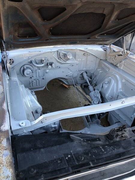

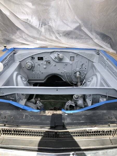

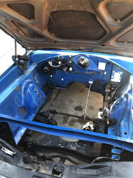

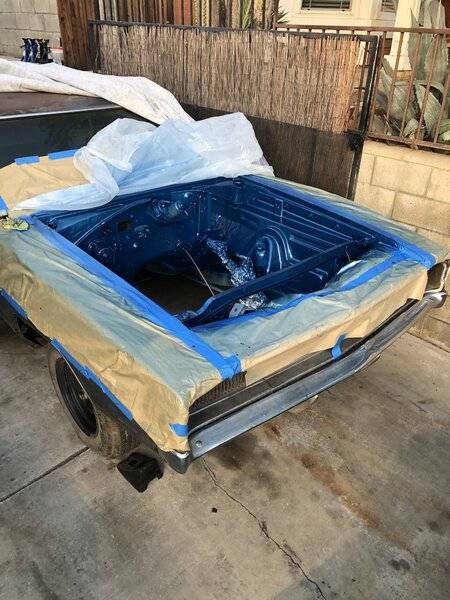

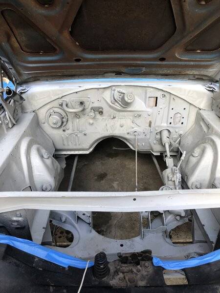

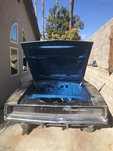

Once that metal work was finished I had a local glass guy come by to reinstall the rear window. After that I took the car to a sand blaster to have the engine bay and undercarriage blasted. (Yes I know sort of backwards after metal work) I had the guy spray some primer after blasting just to keep the bare metal sealed from the elements. After the car was back I began sanding the engine bay in the hard to reach spots to prep for paint.
BEB31DB8-7082-4BFE-8B64-0943E2C68E2B.jpeg FBF4F4AA-94BF-4923-86E7-43078975B1F4.jpeg 2A48852F-56C3-45CF-95B8-4869F7C23AC2.jpeg 98327962-09C6-40E7-96C2-0D896D502E71.jpeg E98A4125-1D19-4829-9F8A-AC9589A166B0.jpeg D7F4766F-4486-4278-B34C-FE413B58E73A.jpeg 1013D71A-E790-43A0-BF58-5BEC43409C24.jpeg
ALL the 'usual'rust spots you've illustrated. Sorry for that. But, totally normal. Get'r done!

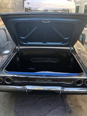

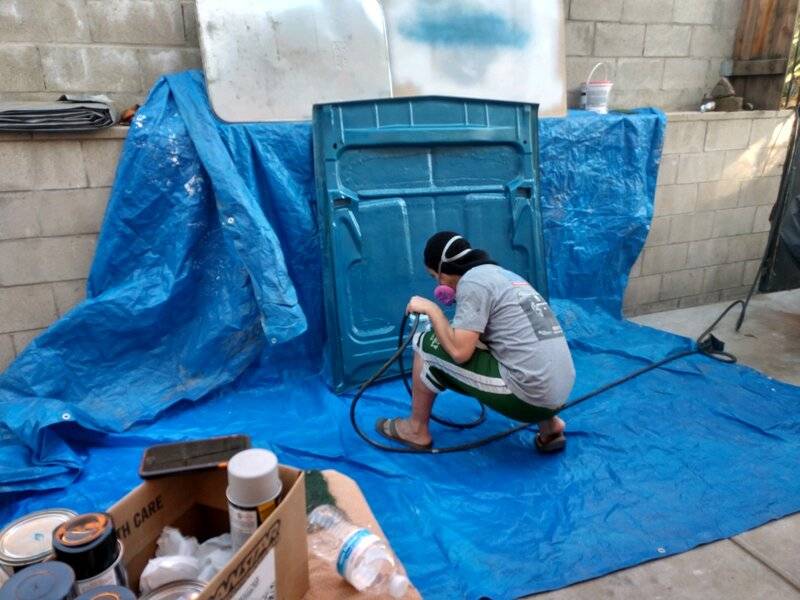

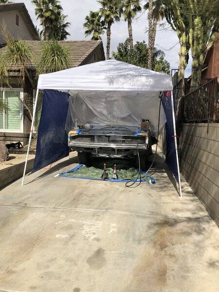

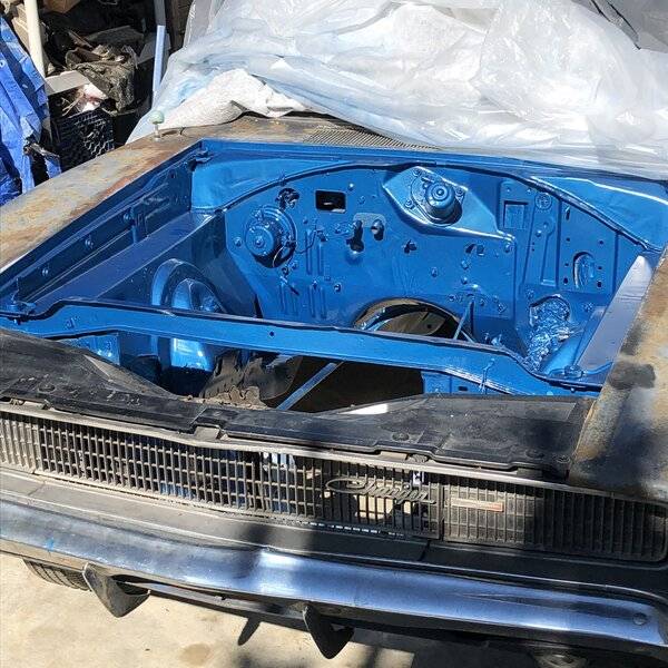

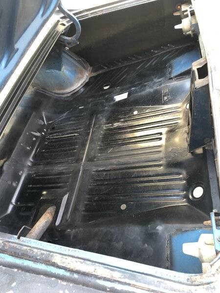

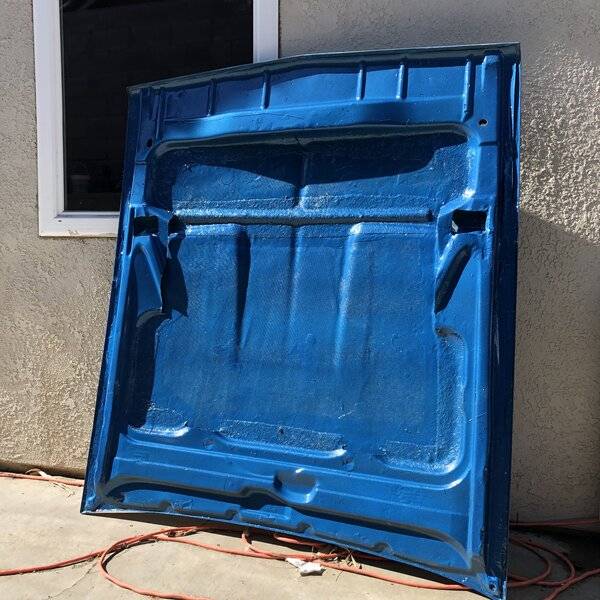

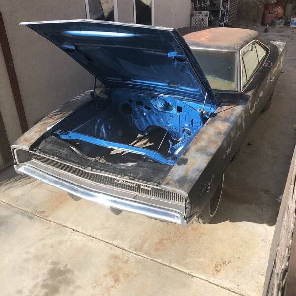

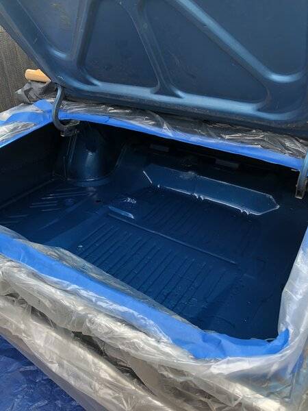

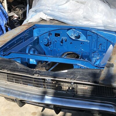

Thanks everyone, very typical rust but not as bad as others I’ve seen lately. Seems like it was a factory option for rusty trunks? Haha. Once I prepped the engine bay I shot it with some QQ1 blue mixed up by a local paint shop. Not my best but it’s been 15yrs since I last sprayed any paint on a car. Had enough left in the gun after a second pass in the engine bay to shoot the fiberglass hood I picked up. Happy with the results & a few weeks later I sprayed the trunk as well. First with some undercoating and then the QQ1.
769FA8CC-8999-472B-A768-CCAE63EA88EE.jpeg 7D6131AB-AFA3-4FD0-9935-78F84BD2D9F4.jpeg 6E199EE1-5AEF-4231-AEA2-0CC99C616E6B.jpeg 4D813441-7974-46AC-BEEF-72B30585B5E7.jpeg EB198F16-9ECC-45FC-85F6-982A543E9F64.jpeg 3E0E9B68-0DE3-476B-A110-999D6DD21DAE.jpeg FB56A257-33DB-4F84-A5B1-1B7271FF6E68.jpeg 80490F4A-5114-4030-A5F4-E4DBBD9EF0D2.jpeg 3A2A7D05-3840-4C5A-B75A-516D14734DA4.jpeg

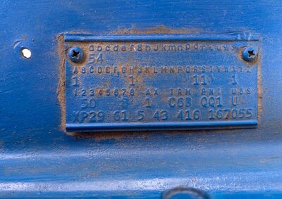

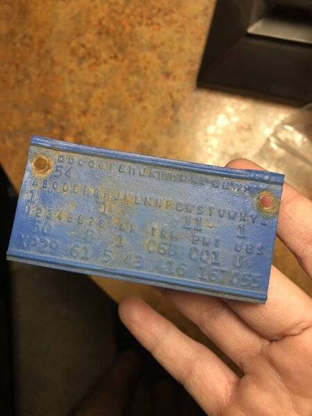

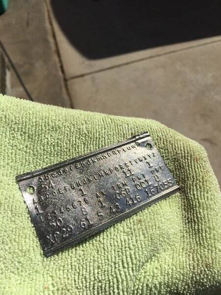

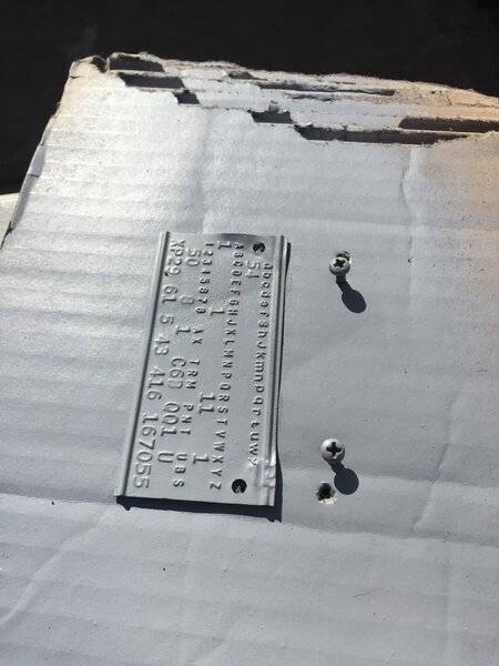

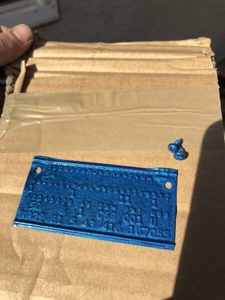

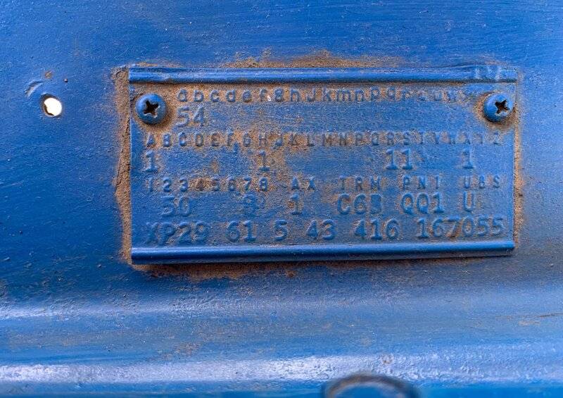

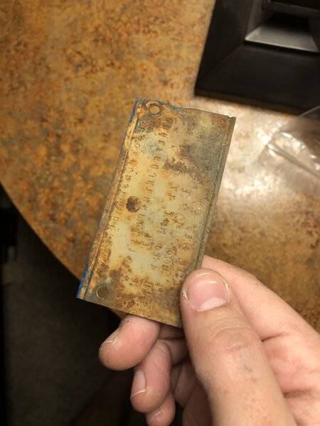

Here are shots of the trunk when I painted it. Also shot the fender tag I forgot about it when painting the first time around. Used some rust remover and cleaner on the fender tag just so I wouldn’t ruin it trying to grind paint away.
