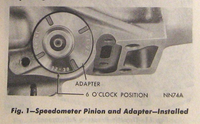

I know this was discussed before but i'll be darned if I can find the thread. What's involved involved in changing the speedometer gear in a post 66' 727?
If i recall there was some allignment issue to watch for? My new gear has black marked on one tooth. Does that need to go in at a certain point?
The speedo housing has numbers n it...This will get you in the ball park for clocking it correctly..You,ll still have to turn the housing a liitle till it line sup correctly..

Here is a picture that should help you out.
No you don't have to line anything other than to index the adapter as shown.

Great, thanks fellows!! So the adaptor is alligned to the 6 o'clock position to correspond the the number of the gear? With a 43 tooth gear I basiclly set it to around the 43 position at 6 o'clock???

Yes you do, line up slash mark that corresponds with amount of teeth like in the picture below.

This is a better picture.
Jeff
Yup....align the smaller slot/line with the dot on the housing. The deeper slots are for the clamp to sit in. If you do this wrong, it'll chew up the gear.
Got it - so the vertical hatch mark (not the clamp grooves) that each gear range has is what you line up to the dot?
Super, thanks alot guys. I think I'll tackle this tomorrow.
theres only 4 positions it can go. the clamp will pretty much go in the little slots and bolt with a single bolt. kinda hard to get it wrong just make sure the corresponding numbers on your gear.... and the adapter are at 6 o clock

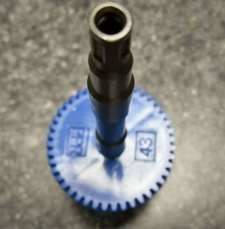

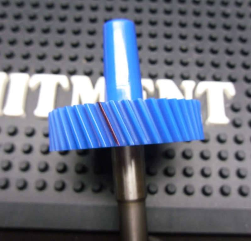

What numbers on the gear???? These are the only markings on my gear:
And this black mark on a tooth - which is about 90 degrees to the number and letters.
speedo
Stumper
I see 43 on the gear the no. of teeth.
Just line mark on the adapter 39-45 to 6o'clock and you got it.

So other than making sure the adapter is lined properly to the 6 o'clock position, is there any particular position to put the gear itself in???
Put the gear into the adapter and then align the adapter with the small notch or mark that's in the 39-45 range at 6 o'clock...and make sure the o-ring is good or it'll leak.
