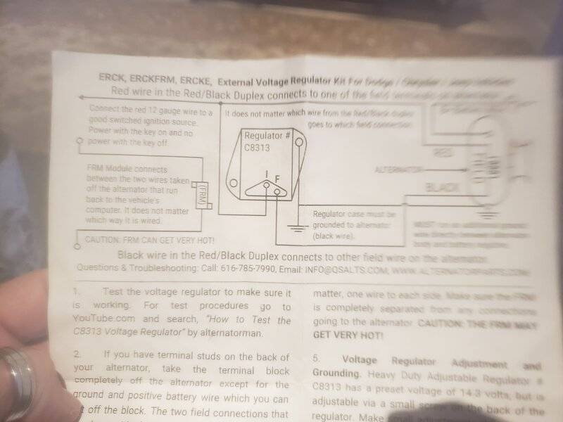

I used this on my '67. I converted to a serpentine setup that uses a 140amp alternator from a '94 Durango. It works great. Sorry they're blurry, my phonecameralense it cracked.

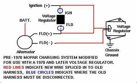

I found this and posted if anyone else needs it...pigtails can be purchased on ebay or other places

Most of the replacement regulators for 64's are electronic. Just make sure the regulator frame is properly grounded to the firewall.
