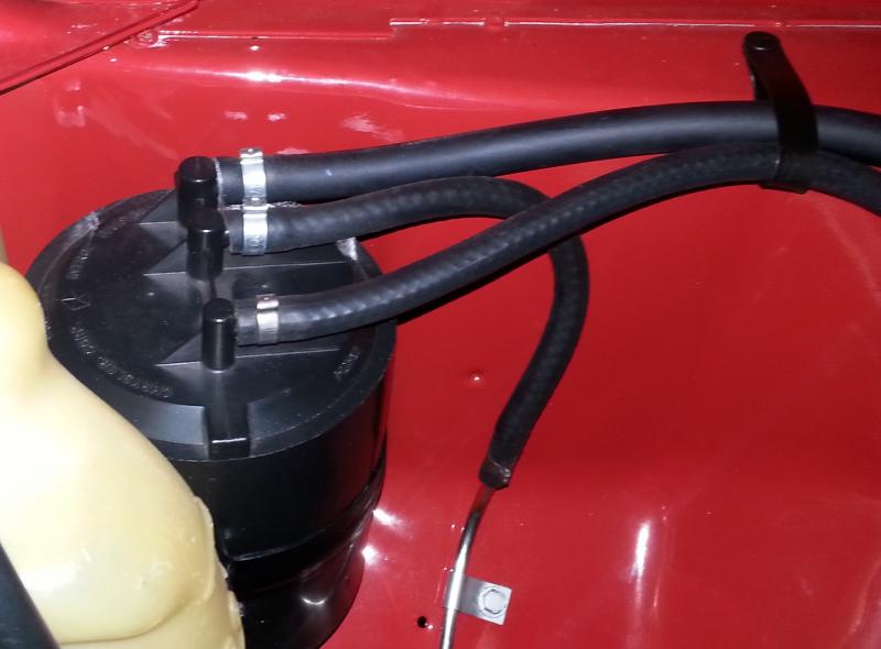

My 73 Charger has the same canister as your 1st picture. It came off the assembly line without any clamps on the hoses. I did put a gear clamp on the large hose that goes from canister to top of carb several years ago as hose kept slipping off.
From what I understand, the canister should have pinch clamps. Originally mine did, and here is a picture of it restored with the correct style clamps installed on the hoses. I guess I should restate, its a NOS canister, as there is not a way to restore originals, but the clamps were replaced with correct style clams.
This is from my 73 RR.
’73 b-bodies used a three nipple canister as you have pictured (3577595), by ’73 there were no differences between California and federal production relating to emissions equipment. To be fully/correctly functional, requires an OEM carb with a dedicated ported purge fitting. The version pictured with three studs in the top surface is a generic replacement of some kind. The clamps originally used are referred to as “Keystone” clamps, commonly used by the factory on fuel and emission system hoses not expected to be serviced often.

Good to know those are keystone clamps, interestingly enough, they are used in sprinkler systems too , I have always just called them pinch clamps. ODZKing, yes, the original style canister, the only serviceable part on it is the filter on the bottom of the canister, you cannot service anything else.
If you are looking for the proper clamps, they are also available from OETIKER. They call them "ear clamps"
