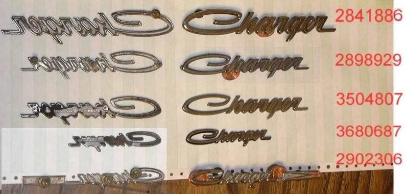

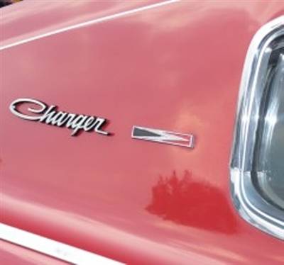

On the 66 Charger --- was the Charger emblem on the sail panel all chrome, or chrome with black on the sides?
this is what I found by Google
66-67 charger
It's a satin black I believe. I have a new one up in the barn, just came in from there.
Shiny chrome with black sides I would assume.
Was the 66 original any different than a 67 original in that respect?
I bought the repo that is basically for all Chargers.
It has two pins instead of three.
No problem since the extra hole is covered by the script.

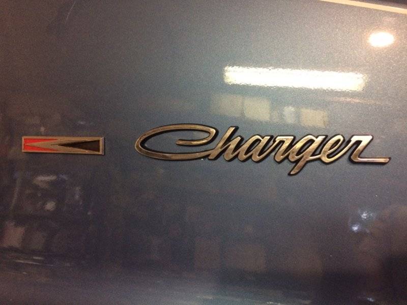

Always chrome with the black sides. 66 & 67 had 3 studs and in 68 they went to 2 studs BUT the emblem is the same.
This pic does not show the 3 stud one but you will get the idea.

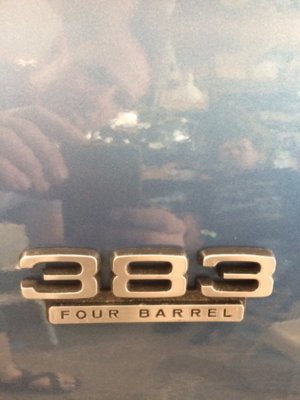

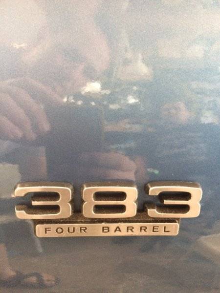

Chrome with black sides, similar to fender emblem (383 four barrel, 440, V8 etc.). If you take an emblem, paint the whole thing, and then quickly run the face over a flat Scott blue paper towel with laquer thinner on it, it will come out nicely. It’s hard to get the paint on only the sides, doesn’t always adhere well. May need a couple coats. Try etcher first coat or two.

66-70 are the same except for the studs.
Then as you see they got smaller and a bit different.

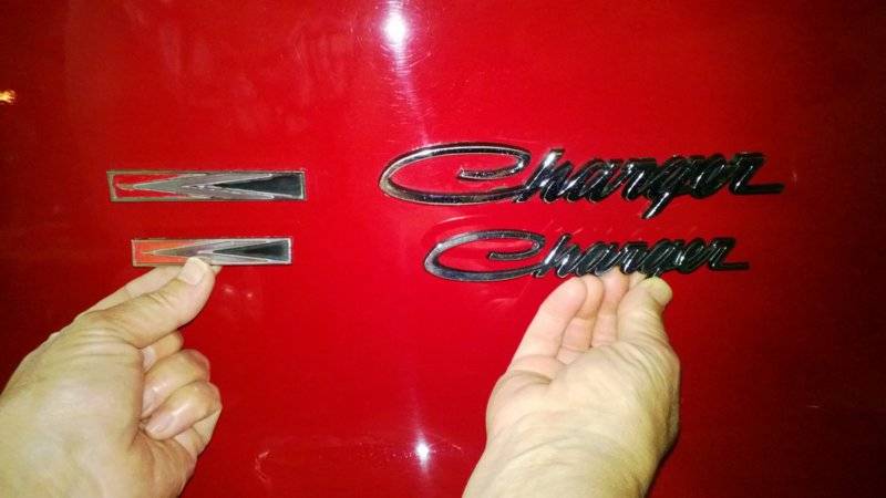

Here is my 67 and my 73 door emblems next to each other. 73 were smaller ans stick on.
