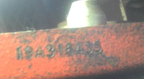

I've owned a 1968 R/T 440 Charger since 1981. I do not know the car's history previously. I have no build sheet. I pulled the motor recently and looked to check the engine serial no. for the first time. The engine sequence no. - 8B334975, is one digit off from the window VIN sequence no. - 8B334972. The last digits do not coincide! Is it possible the lines workers would mistake the die stamp numbers 2 and 5 occasionally due to their similarities? Anyone here heard or seen a similar situation? Thank you in advance!

My mistake ----- engine sequence no . 8B334875 and Window VIN sequence no. 8B344872

When I posted above it was a statement about line practices, the posted picture wasn't visible to me at that time.... Now that I've seen it I'm less convinced about this stamping... Lets get someone who's more focused on these kind of details...

Stamps look fine to me. Camera optics makes them appear "proud". As for dates, my Bee's SPD was Feb 25th, my engine was built on the 26th and my drivers side exhaust manifold wasn't even cast until the 27th.

So, just my opinion... The font looks like a generic hardware store stamp... But being a 68 the whole VIN stamp thing was new & plants were still working on the details.... My computer that I had saved a number of 68 VIN stamps to crashed awhile back... Currently I have to search the web for photos... My recollection of 68 Hamtramck VIN stamps they were similar to the Belvedere stamp...
Belvedere Stamp
Lynch Rd Stamp
I couldn't find any 68 Hamtramck stamps on the web... I'm sure they are out there... I didn't find it..
But another thing to notice it the tilt/cant of the letters... There is some up & down movement of the Belvedere letters but they aren't tilted... The Lynch Rd stamps aren't tilted & actually are pretty much vertically matched too...
The O/P's numbers are tilted quite a bit... Like they were stamped free hand... Anybody here actually believe every letter/number on every engine was individually stamped??? They were held in a fixture that kept them clocked...

Okay, apparently the boys at Hamtramck were drinking overtime.... :lol:
Odd the engine numbers are straight & the transmission numbers are all over the place..
