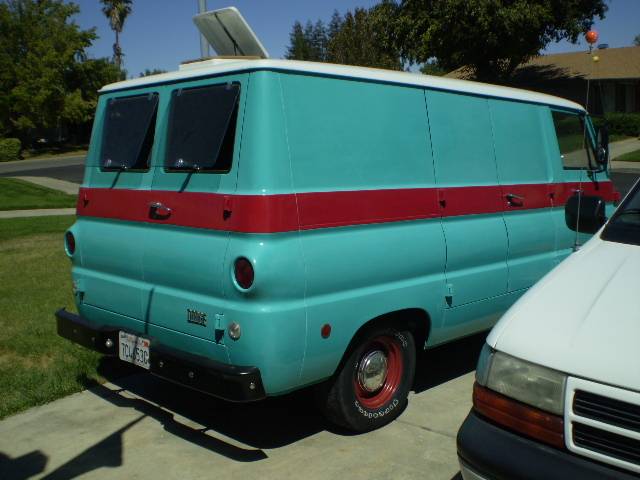

I have done something similar with a A100 backup lights I had a cop have a hissy fit because one of my BU lights didn't have a lens on it, try finding a BU lens for a A100? So I did the aftermarket gig like you, I had to hog out the hole to make it fit, works good! I got mine at NAPA and for the life of me, I can't find them on their site. Not the greatest pic, but you get the jist. Good Luck

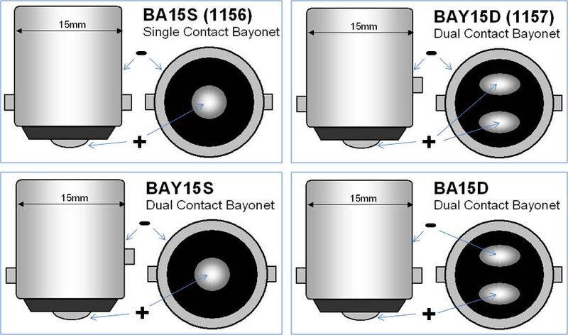

Just curious but the single element socket #8544 does not mention compatibility with an 1156 bulb. The 1141 bulb stated is the same size but is only 1.4 amps and 18.4 watts while an 1156 is 2.1 amps and 26.9 watts. Some bulbs mentioned are 6 volt but none of the 12 volt compatible bulbs are high wattage. I wonder if that particular socket would have difficulty handling the current. I wouldn't think you'd want a dimmer bulb for your tail lights.
Maybe just missed to add that bulb to the list but I can assure you will hold the load.

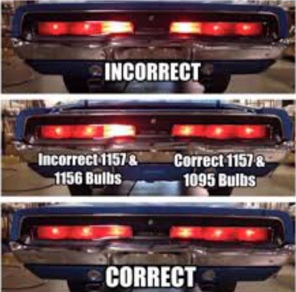

Need to note 1156 bulb is NOT CORRECT for the tail lights. It actually used for back up lamps on most of the cars. Dunno if on 69 back up lamps use those, but wattage is the higher one, just like the high light wattage for brakes on the 1157 dual filament. The 1156 will make to light up tail lights as many of the wrong setups not uncommon to find around.

Sure one watt between 7-8 W won't make a huge diff when selecting one or the other, but going to 26 watts will do. That's in fact aprox the diff between parkings and brakes/turnings

Aside what I told about the brake signal/position won't melt anything since is not constant on, the 1157 bulb won't fit propperly on the single filament socket kind. Bayonet socket keys are at diff height on 1157s to be sure will be conected in just one position with the right signal for the low and high intensity filaments... and still if you make to insert it into a 1156 ( or same series ) socket, contacts could or could not reach the center contact of the socket, depending on contact size on socket and bulb
I put #89 bulbs in my inner sockets recently, they give the correct "dim" running light level. I couldn't find anything else that would go there, with proper wattage (the car had incorrect 1156s in it when I bought it, looked like 2 brake lights were stuck on).
