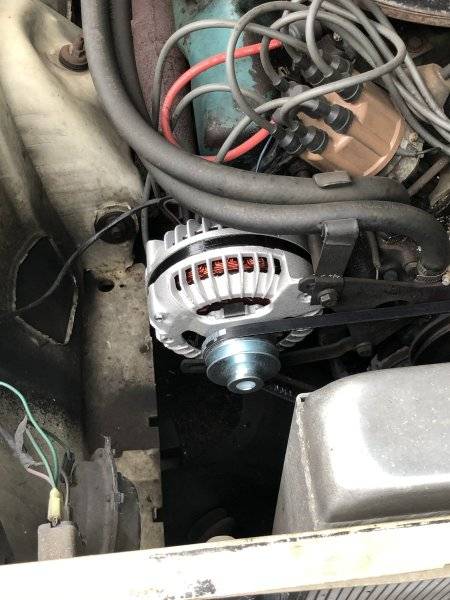

I recently experienced a no charge condition on my ‘68 Satellite it still had the original 35 amp alternator and a replacement voltage regulator. I got a new alternator for it and it worked for about a week. It’s now only moving the amp gauge to about zero if the engine is above 2500 RPM with no accessories on. I ordered a new regulator. Has anyone seen this issue before?

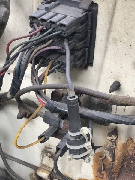

It’s not working right. It goes over to discharge when I turn the headlights on. And the engine starts missing. It’s running on the battery. I have to check the fusible link that goes from the relay to the bulkhead. It was replaced at some point with an inline fuse.

Thanks! I put a new alternator in and it worked for about two weeks. The lights did flicker at idle, but with everything on in the morning... headlights, wipers, blower it was at zero or showing charge. It’s now just showing discharge, and the engine misses when hitting the gas. Nice thing about the amp gauge, it shows that it is running off the battery. I do have an Optima in the car. I’ll check grounds today but I’ve been meant to replace a garage fix that was on the car when I got it. Instead of a fusible link, someone installed an inline fuse. No problem there. But the holder broke about 5 years ago and I just used plastic zip ties to hold it together. So I ordered a new (Ford) part to install. Here’s the one that was replaced. It probably overheated, and the guy cut the bulkhead connector to install a new spade.
