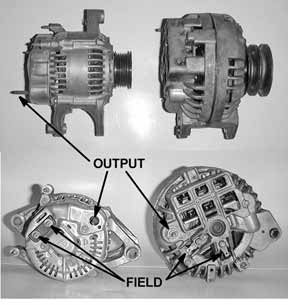

10. The late-model Nipondenso alternators (left) can be retrofitted. Mounting is basically similar. Stud (not called out in pix) is used instead of Indy-built (right) unit’s 5/16" threaded hole for tensioning bracket, but this is of little consequence. Pulley bolts on and is easily replaced or swapped on ND unit. Wiring is easy (see photo 8.) Biggest hassle is extra depth (thickness.) In most cases, it still fits, but output stud must be shortened and insulator (to splash shield) discarded. To prevent potential major-league short circuits, simply cut away the splash shield as needed.

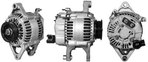

aaand:
The Nippondenso 40/90A alternator used from 1989-1995. Identifiable by a tag which reads 'FAMILY 90HS' on OE alternators, or by the elongated ears on the rear housing for the mounting of the wiring harness. Similar versions of this alternator and its 120A sister were, and continue to be, used on all manner of Chrysler-built vehicles.

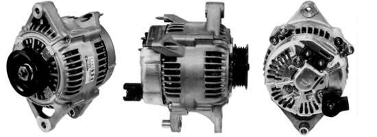

or
The Nippondenso 50/120A alternator used from 1989-1995. Identifiable by a tag which reads 'FAMILY 120HS' on OE alternators, or by the short, stubby ears on the rear housing for mounting of the wiring harness, and also by its oversized case.

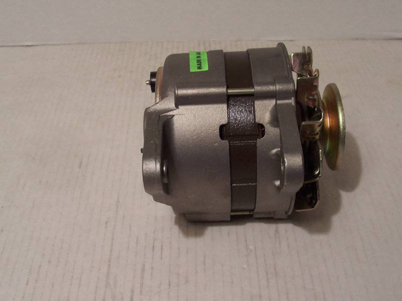

I did some more research the alternator I used was a 1983 Honda civic ,I just bought this one reman $39.99
