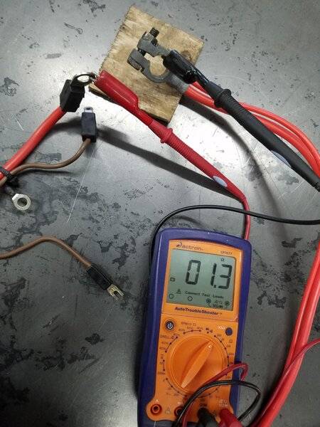

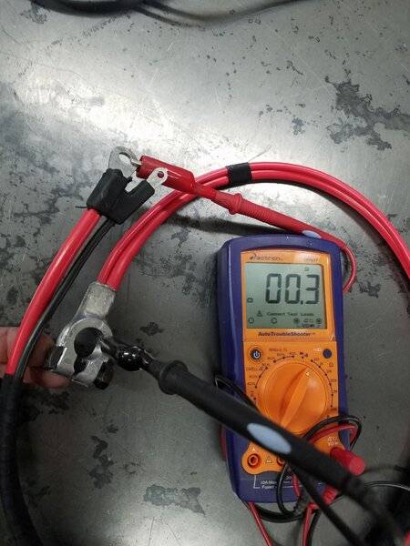

Thought I would share this info for anybody interested in such things. I had a no start issue last fall on my 69 Bee. After wiggling the positive cable on both ends, it started normal. This was one of those $40 cables sold most everywhere. Really not sure why I bought it in the first place, but ordered one of the better $130 versions to take its place. Interesting that the cheap cable showed 1.3 ohms and the better one measure .3 ohms. Not a lot, but would change the voltage drop when in use.

When you begin with only 12. x volts, any resistance can and will be a problem..

Cable diameter is not what it use to be. Go to a truck shop next time. No amount of connector will do the job with undersized wire.
