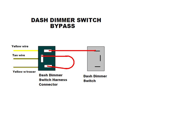

You can bypass the dimmer wheel, by unplugging and using a couple of short pieces of wire, 3 male terminals and 1 female terminal. After bypassing, dash lights worked, and you can use the wheel to turn on dome/courtesy lights, but you can't adjust the brightness of the dash lights (but hey, they aren't too bright all the way up anyways).

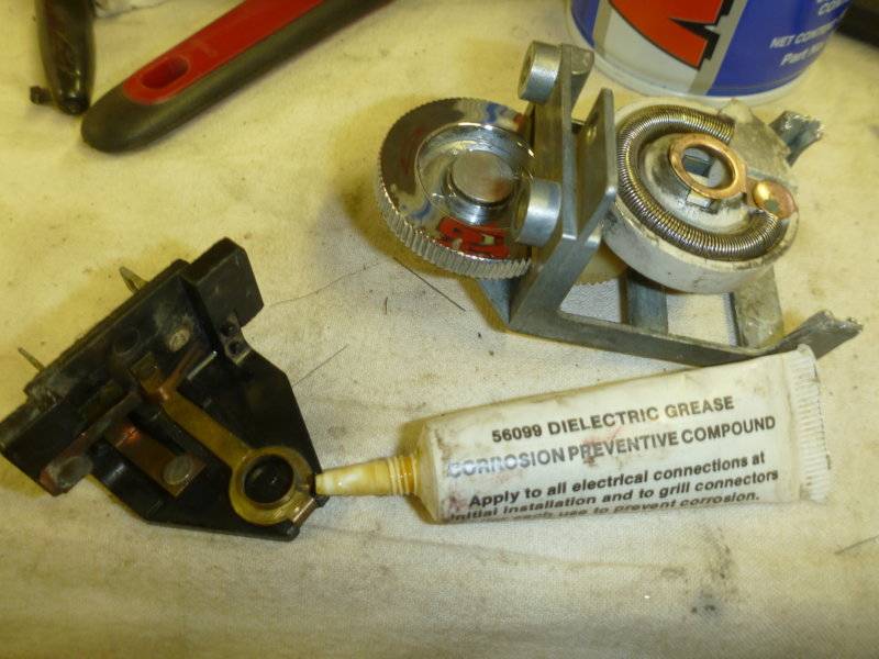

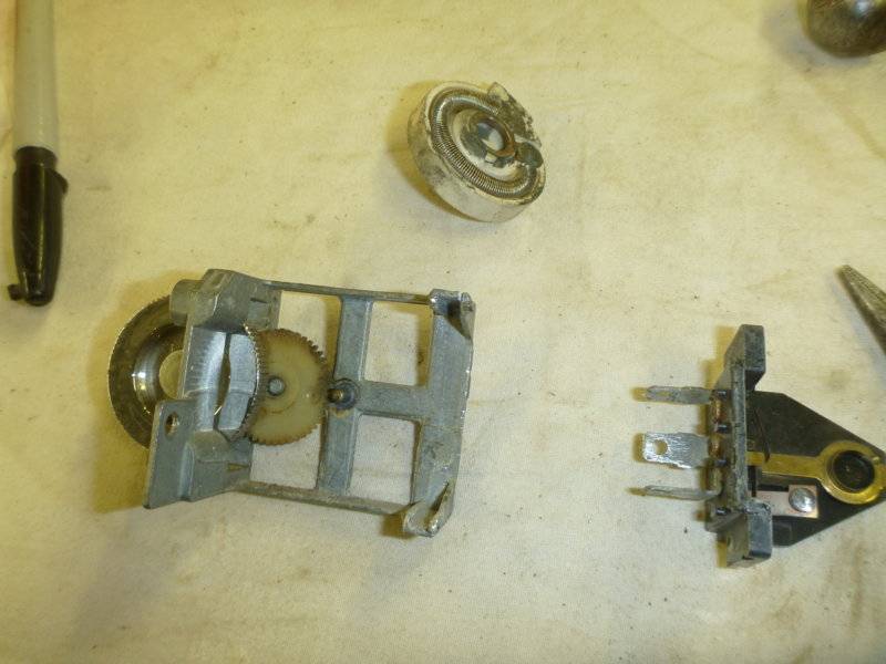

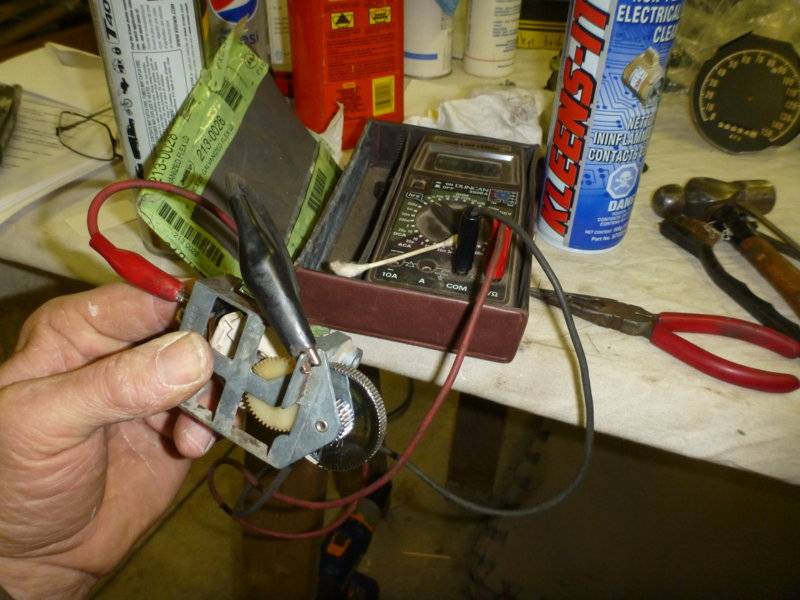

Yup......Devininsm is the guy that rebuilt both of mine. I see he raised his price but he does have a $25.00 core charge included on the ebay auction. Maybe he gave me a better deal for sending two for rebuild. You can try rebuilding it yourself but without a new rheostat, you are probably not going to gain much. It costs a lot of money to keep our old iron alive and well.
