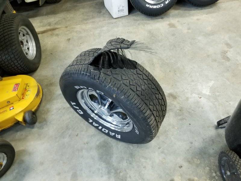

I had another failure today, this is 3 in as many weeks. Every one has been with the car parked and tires 5 years old.

I had another failure today, this is 3 in as many weeks. Every one has been with the car parked and tires 5 years old. View attachment 861454
Wow, remind me to not buy THAT brand! What are those, like "Road Hugger" or some such?
Who makes that?
Who makes that?
I'm not sure who the manufacturer is, didn't look that close, have experienced the same thing with BF Goodrich TA radials, Goodyears and the Hannook tires. They just had a little more age on them. My cars are all stored inside and the tires I have had trouble with showed no signs of dry rot. The tires on this car were on it when I purchased it and were new at the time.

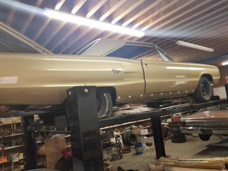

Look closely at the rear tires on my 67 R/T. Exactly the same thing.
I already had it in mind to replace the BFG's on my GTX this winter (less than 1000 miles, but over 10 years).
This thread just reinforced that for sure...
