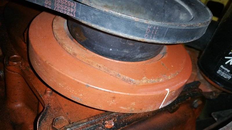

It has an "eccentric" weighted area shown in the pictures.

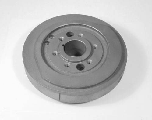

No. Forged cranks with LY rods were internally balanced with neutral balancer. Forged cranks with 6BBL rods were external, using a special balancer. Most passenger car forged cranks were LY rods. Trucks and HD deals might have LY or 6bbl.
Thanks khryslerkid. So it appears that my 71 440 in my 70 V-Code 6bbl equipped Roadrunner is a 440 forged steel crank motor with 6 pack rods??

My harmonic balancer:
And the one from 440 source followed by their description:
Shown above is damper #3512017, commonly known as a "six-pack" damper. This damper can be easily identified by a small .210" thousandths thick elliptical weight attached to the center hub. This version was used in '70 and '71 and has the offset pulley bolt pattern.
Yours is a 6-pack balancer. 70-71 440 hp motors used the "heavy" 6-pack rods.
I've had truck 440 motors thru 1978 with the heavy rods.
I've had truck 440 motor thru 1978 with the heavy rods.

No - Installing the 6bbl balancer without the heavy rods would create a problem. If it runs well as-is, they may have had the engine re-balanced with the original balancer. Or it still has heavy rods in it. Most anything is possible after this many years.
You have the 6 pack balancer and rods....if I was betting in Vegas.......
All of the later HP motors were heavy rod. Unless the motor has been apart and assembled incorrectly that is the correct balancer.
Pull the pan and look. Better than installing it in the car and finding out its incorrect.

Just looking at your harmonic balancer, I'd say you have the "big" aka "six pack" rods in your 71 motor. I think it's a good idea to look inside the oil pan....why not? The six pack rods will be just as thick up by the piston as they are near the crankshaft ends (smaller LY rods get skinnier near the piston end).
Now, "assuming" nobody has internally balanced this motor (assuming), then you may have the wrong flywheel....maybe. On my big rod motor, the harmonic balancer, rods, pistons & flywheel all figured into the engine balance. I had my flywheel checked on a balance machine & was told it shook like crazy.....so my engine is externally balanced (including the flywheel).
harmonic balancer, crank, pistons, rods & flywheel are a "set" on an externally balanced engines. This makes swapping flywheels a pain in the butt. If an engine is internally balanced ("zero balanced"), you just have make sure whatever part you swap is also internally (zero) balanced...piece of cake.

If your motor runs another with the 6 pac balancer then it has the heavy rods. It should also have an externally balanced flywheel. This can be verified with the flywheel removed. Spin it up on a wheel balancer. Externally balanced heavy rod flywheels are availible.
