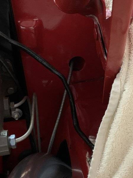

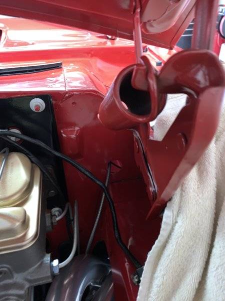

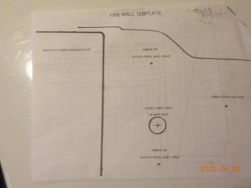

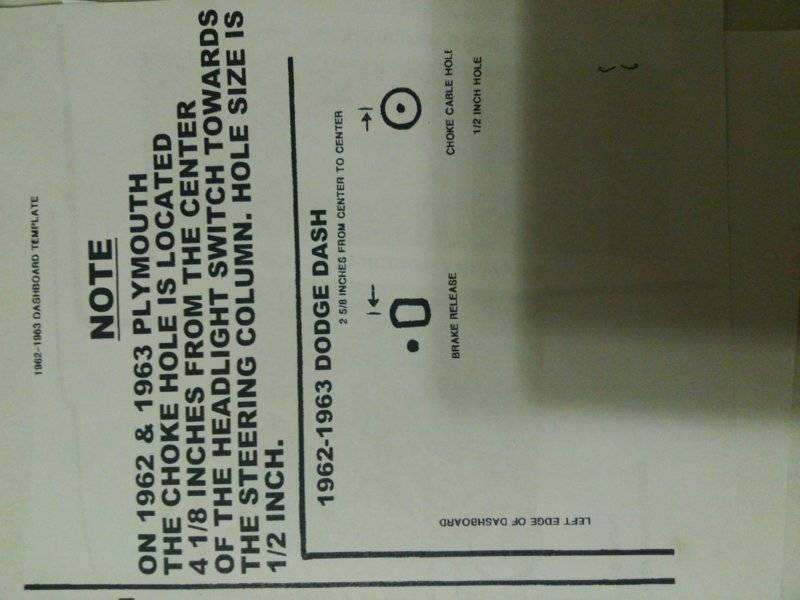

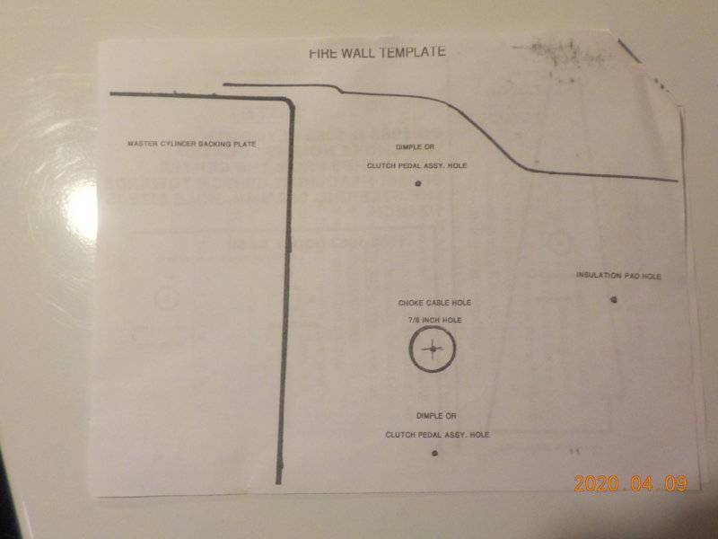

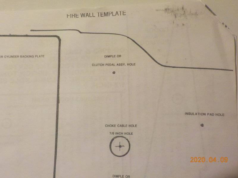

Thank you so much for the reply! I have the hole in the dash already and the cables are in place. I am looking for the hole size on the firewall to run the cables to the carbs. Also the correct grommet to fit this hole. Any help appreciated!
Jeff

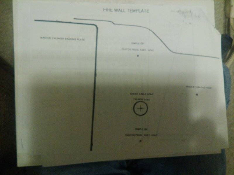

I spoke too soon! LOL. That is awesome. I hate to even ask after that but can you take one more clearer picture of that last diagram. I owe you one!
Here is Choke location, I believe to be correct and matches your diagram. Second is my project car at 80% give or take. Thank you again. Any idea where to get a speedo grommet for the factory 1 1/16" hole? And who sells the grommet for the 7/8" hole choke cables. Sorry for all the questions!

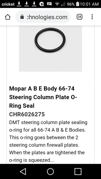

I looked through 19 pages of listings on Detroit Muscle Technologies last night looking for interior trim clips I need. Didn't find them ... but I saw choke grommets. The Search key on their site is pretty lame (at least from my phone) but it looked like they have a LOT of small and hard to find parts at reasonable prices.
https://www.detroitmuscletechnologies.com
