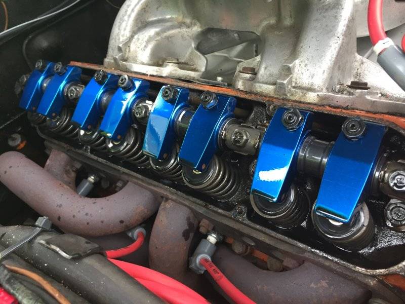

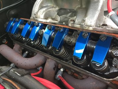

Rocker arms are some old days Mopar Performance type 1.6:1 ratio type. (see picture)
As per their instruction i should set the adjuster to expose 1 thread below the rocker arm, then set the adjustable push rod to that length and that's it.

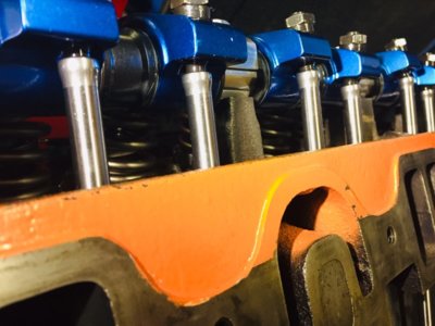

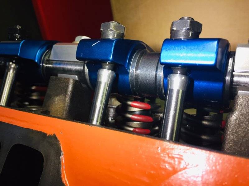

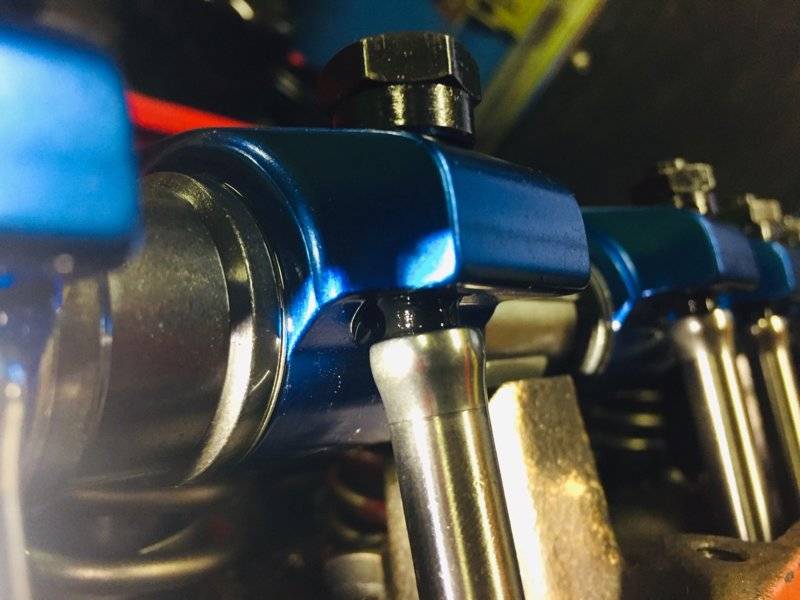

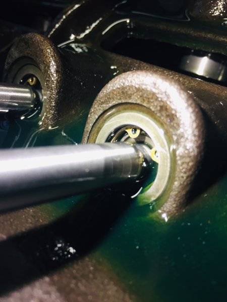

Smith Bros makes some really nice stuff. Definately could have been a smidgen longer on the pushrods. Whats the sweep look like on the valves with that correction kit?? :thumbsup:
What do you mean? These push rods could have been longer?
The adjusters are barely showing 1 thread, and i did not want to go higher because of the oil hole providing oil to the push rod cup sits quite low on the rocker arm.
The sweep is now perfect, 0.035-0.040" and centered.
