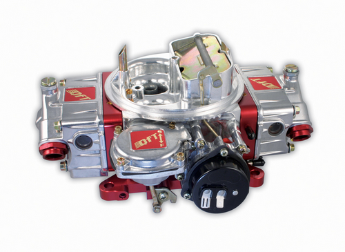

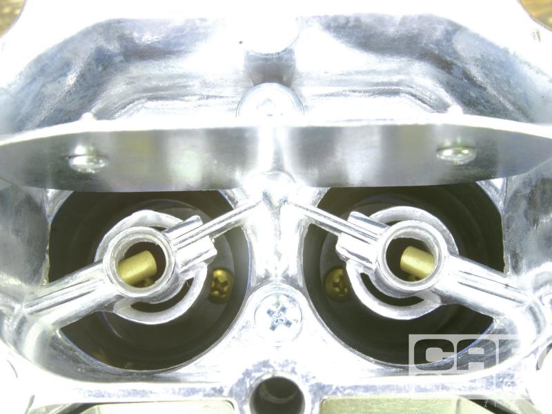

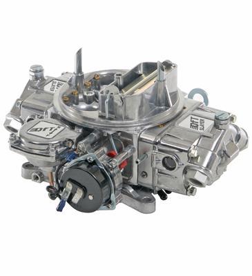

I've never tried one yet, but might be a contender, a Demon "Spread bore" style 625cfm Street Demon w/vac. sec. & w/electric choke... or even the tried & true Holley Spread Bore 650cfm style carburetors, both style carbs have smaller primaries & larger secondaries for better mileage & then performance when you mash the throttle down... or maybe a Quickfuel 600cfm vac. sec. SL-600-VS or SS-680-VS QFT vac. sec. series of carbs... all good possibilities... check either sites

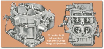

But I'm betting on your intake is a square ore carb, not a spread bore like a TQ or the QJ.
