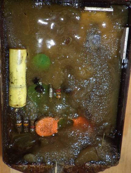

I have a chrome box on my 67 gtx hemi. been there since the early 90's the other day i see the gel has melted out the back of it and is running down the firewall. any idea why that would happen? Is the box still good? never seen this before. Maybe i'll go back to points since you cant get the gold box anymore.

Some of these deteriorate over time. A post I read said it was due to the "mix" between batches if I recall. This one, not a chrome, leached out just sitting in a box for years......

I have a chrome box I bought new in 1978 from Poway Dodge that did exactly that... Sitting on a shelf in a box & the potting material melted.... It worked when I set it aside so I bought some modern bedding epoxy & re-poured the bedding... It still works fine...

The breakdown of the original potting compound has nothing to do with the function of the electronics unless significant moisture is allowed to get to the internal components. I have seen the original potting compound breakdown on units never exposed to excessive heat, in storage and in their original boxes. If it still works, seal it back up with a modern epoxy and run with it.

The epoxy is just soft. Maybe from just being old. last i ran it the box wasn't hot but the epoxy was very soft. I think I may pull the chrome box off and take a look at it. I have an orange box that I got with the electronic kit that I keep as a spare. probably form the early 90s or late 80's. still on the fence about going back to points. may end up doing that in the long run.
When the Chrome box first came out years ago, I remember reading that they were meant for race only and not for daily drivers. I really have no clue as to why it was but may have something to do with being energized for long periods (like a 200 mile trip) overheats them.
There are several semi-conductors that are internal to the box. The programable device that interprets the reluctor pulse is constantly being switched on and off at a changing rate (RPM of the distributor). This device controls the transistor on the outside of the case, which switches the coil current to create the spark. If the owner decided to use a non recommended coil, or a non recommended application (everyday driving), the situation is exacerbated. Higher internal current leads to higher internal losses (heat or I2R losses), will eventually melt the potting compound. Just my opinion of course.

Good to know. its been on there for 30 years. probably only a few thousand miles. old mallory voltmaster coil from the 70's. maybe its time to replace everything
