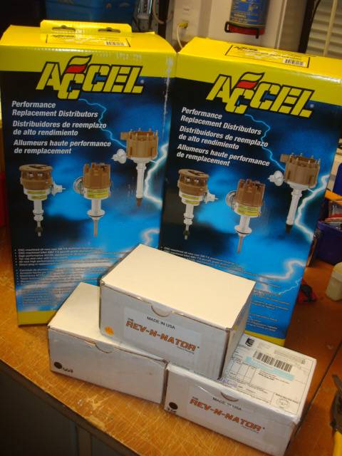

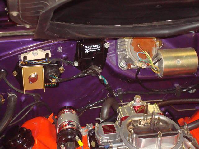

I don't know about the best deal, but if you Google Accel #59300, you will get a very stock appearing distributor which has adjustable advance inside, and out performs the stock unit. Easily hooked up to the stock ECU, or like I have done - a Rev-N-Nator unit, which has a number of very cool features built in.
I'm fairly sure it's the stock look you are after RC, so consider these options :headbang:
I went with the Pertronix Ignitor in my 66 Charger w/383. Quick easy swap out for the points. Everything else stays in place. No need to add an ECU, swap coils or remove the ballast resistor.
The ECU has 40-year old technology with equally aged internals. The Rev-N-Nator as an example is a modern twist - modern design features, some extra goodies, and state-of-the-art electronics & software.
