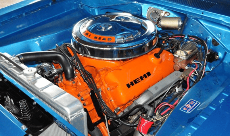

Don't care about your judgment of me. And I think the trade off for more room is worth any sacrifice in some strength. So stick your "True" judgment where the sun don't shine. Besides, I've called it a rocker bar for more than 3 decades. And no one but you whined. My current Plymouth's (all with Rocker "Shafts" if it makes you feel better.)

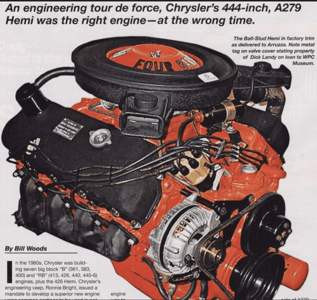

Mopar developed a gen 3 hemi with ball stud rockers for '72- but the gas crisis hit and it got nuked.
"The Ball Stud Hemi"

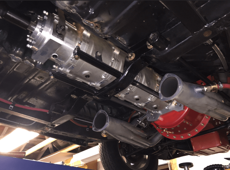

Actually, its not entirely true. The Cuda did have 2 shafts per head at one time in its life. But now DOHC build. One way to settle any debate? Get rid of both designs? Lol.

Yeah. I've seen that article. Some called it Chrysler made a Chevy big block. Some called the obvious evolution. I wonder how that design would have held up?
The motor is still around and is running in a car. The guy that bought it from Dick Landy hacked it up into a hotrod motor (bored it, ported the heads, ported intake, stroker crank)
and destroyed a piece of history...
:mad::mob::mad:

I agree. And check ALOT. I've learned that the hard way. And that's with just flat lifter at .600 lift. I can only suspect the bigger roller world would be even more concerning? Big Hemi builds are a different animal.
The 904 DOHC Schubeck marine engine I have in my Pro Street Cuda build intimidates alot of my mechanic friends. But in reality? It's simpler. The size simplifies. Everything is so big it's easy to see how it goes together. Personally? Little components scare me. Yeah 4 cams can look complex. But it's not. They only assemble one way. To have it missed aligned is very obvious. Its transmission options that is holding up this build.
