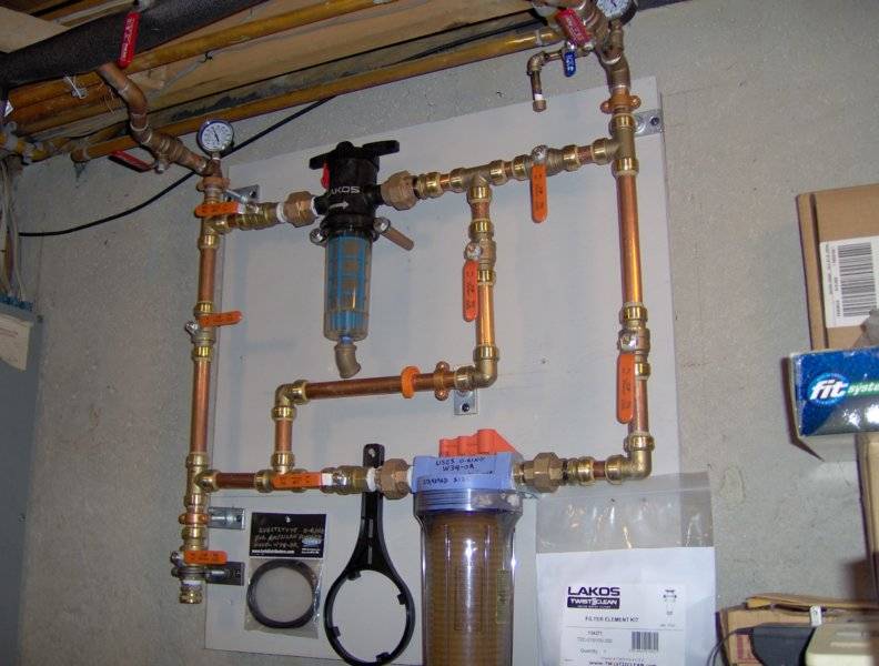

I have a well in my neck of the woods and that means minerals and iron which vary depending on the water table. I got tired of cleaning aerators and was worried for my new dishwasher; (had to take apart the solenoid valve several times on the old one), so I installed a low maintenance filter system that I designed myself. Pictured below. The top filter, 74 micron, reverses flow so it backwashes it self simply by turning the top valve 90 degrees and pushes the crap off the outside down the drain. The second filter is a standard cartridge and I change them about every 6 months of so. I started with 5 micron and am down to 1 micron. I am quite pleased with the results. I designed the system to run off of either filter alone or using both with first as a pre-filter or bypassing the whole mess. If you look, I can also back flush the lower filter as well. I also put air bleeds on top and inlet and outlet gauges to monitor pressure drop.

I have a well in my neck of the woods and that means minerals and iron which vary depending on the water table. I got tired of cleaning aerators and was worried for my new dishwasher; (had to take apart the solenoid valve several times on the old one), so I installed a low maintenance filter system that I designed myself. Pictured below. The top filter, 74 micron, reverses flow so it backwashes it self simply by turning the top valve 90 degrees and pushes the crap off the outside down the drain. The second filter is a standard cartridge and I change them about every 6 months of so. I started with 5 micron and am down to 1 micron. I am quite pleased with the results. I designed the system to run off of either filter alone or using both with first as a pre-filter or bypassing the whole mess. If you look, I can also back flush the lower filter as well. I also put air bleeds on top and inlet and outlet gauges to monitor pressure drop. View attachment 638041
Hmmm, I like what you have going on there. Good ideas:thumbsup:
Thank you. The most expensive part was all the shark bites, which are movable by the way. I suck at sweating pipe and would have been cursing my butt off having to drain and re-solder leaky joints. The mess I created could have been worse. LOL. That Lakos "twist to clean" filter is a great design and was the inspiration for the whole thing. I also use "mineral magnets" strapped around the pipes to help with iron deposit removal and that helped also.
I was going to ask about the filter types, I'll look into those.
As for sweating you need to give it another whirl with a little guidance. I've never ever had a joint leak so your missing a step, technique or something? In all honesty I'm probably done messing with it myself especially given how expensive it has gotten. PEX is just hard to beat now days, it's super quick, easy to route, easy to work with, no flames around your studs and it's affordable so why mess around with piles of fittings and all the extra work?
The Lakos filter isn't sold except to plumbers usually. I got it from Bigbrandwater.com. The other housing is a standard model, don't remember the brand, I got it from my father and it was over 30 years old. The filters for it are around $5 & sold at any hardware store. They have many types of filters for it including charcoal. My supply lines are 3/4".
The reason I hated soldering is when doing a 90, 45 or coupling, I'd get one side done okay but when heating the second side the first would let go. Also I ran out of acetylene a couple times when doing jobs. I watched someone else do it after so many years and it seems I use too much heat and didn't clean the copper good enough. I soldered flushing tees on my furnace (tank-less coil) 28 years ago so that I could do my own coil cleaning and that worked fine. freshwatersystems.com has filter systems too as well as cannonwater.net.
Incidently, the inside of both filters is now stained orange from iron and it won't come off! It's good I put the gauges on it to see the pressure drop. LOL

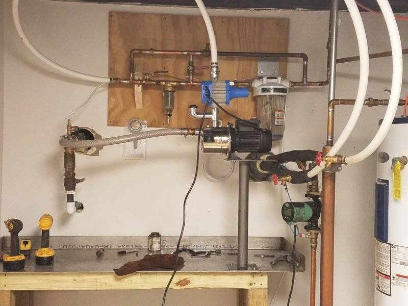

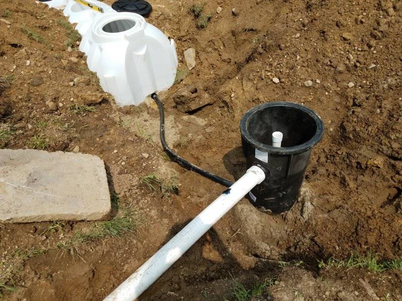

I took the overflow from the existing 500 gallon tank and from a 2nd spring feeding them both into a basin that acts as a sediment separator which then fills the 1175 gallon tank. I plumbed the suction line in above the waterline so all I have to do is reach in the hole and unscrew the 1 1/2" drop pipe so the foot valve is easily changed. In the house I took the recommendation to backflush the filters... works awesome! Last is this super cool pump, no tank required and a constant 60psi.... love it. It's a Canadian brand which senses water flow to turn on, once on it maintains a constant 60psi until the flow is shut off. Thanks guys... the new system is providing cleaner water, more pressure and a lot more capacity.
