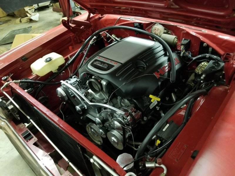

I cannot say for sure as this install is not finished yet, and is more custom than installing in a 67 B body non-air car. The under dash components installed easily and the templates for the additional holes in the firewall were good. In the engine compartment is a 5.7 Hemi with a complete Marsh pulley system to relocate the A/C compressor to the passenger side for a straight line installation. Problems encountered with radiator fitment and the dual fans clearing pulley system. Griffin custom radiator ordered which will give me 1/2" clearance. The dash controls modified without issue. How it works and any other issues are yet to be determined.
