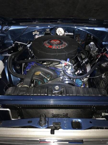

I recently installed a Classic auto air , Perfect fit , in my 67 Gtx , it being the finishing touch on a five year build , would like to say it wasn’t much of a job at all , and it actually fit rather nicely ! My only helper was my wife who placed attaching bolt through the firewall ! I had been studying the instructions online for a couple weeks, prior to having receiving the unit by freight! So I had a plan for install and it went pretty smoothly, except for all the sharp underdash edges , which removed some old skin along the way ! I purposely bought the unit over Vintage for ease of service if needed, and the separation of heat and cooling coils ( don’t quote me on that though) and the service tech ( Dewight ) was excellent on phone couple times !

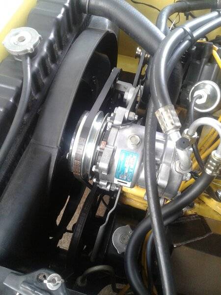

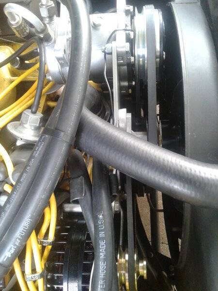

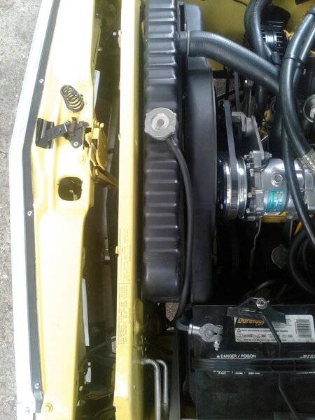

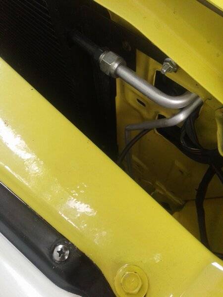

Classic Air on mine also, original non A/C car. Install was really easy following step by step instructions, fit and finish is amazing, hard lines going through radiator core support fit perfect as did everything else. One issue, has anyone been able to install a clutch fan with this system? Stock clutch wasn't even close to fitting (hitting radiator), picked up clutch designed for a jag which clears the radiator but now it's just hitting the A/C compressor. I'm not giving in yet, but re adjusting compressor back throws out belt alignment????? It is an aftermarket radiator but it's the same dimension as stock, took a few random pics, maybe you see something I don't, thanks in advance
Sir , my 67 Gtx non factory a/c , I used a 3” fan clutch , Hayden ( Summit ) and oem 18.5” fan , my kit came with a few spacers for clutch to fan , used one problemly 1/8” and not contact at ac clutch and 3/4” from radiator!
That's a very nice installation @Jc cooper :thumbsup:

Yes sir , mine seems to be spot on so far , hope your works out as well !
Thanks for the help Jc, im a heading to summit site now, I really want to get a clutch fan on this car
