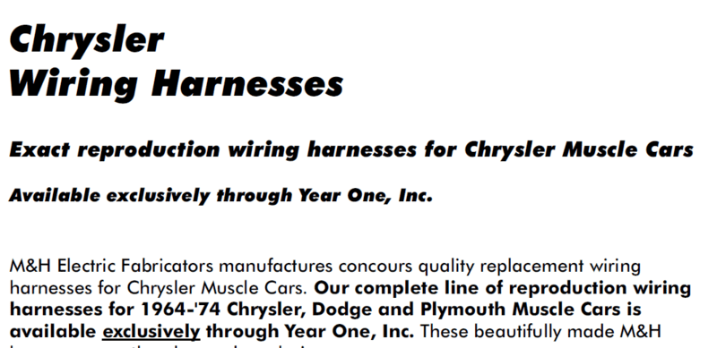

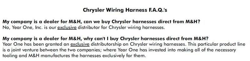

You guys do know that there’s only 1 company that does the Mopar reproduction harnesses and year one classic and all the others sell.. company is M&H and they are the only ones licensed by Chrysler to make them... they’re made in the US in Santa Fe Springs CA. So that guy was blowing smoke up your *** to make a sale saying it’s from Mexico...
Maybe the others aren't licensed by Chrysler? M&H does say that they sell to Year One EXCLUSIVELY, they don't supply to any other seller.
CI is just a reseller/drop shipper, correct? They don't actually manufacture anything, eh?

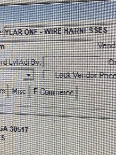

My buddy works in merchandising for classic industries and they buy directly from M&H

CLASSIC INDUSTRIES PARTS SUCK. PERIOD. $100 for a re-man distributor for my A12, JUNK! AVOID ALL of their ELECTRICAL CRAP! ESPECIALLY "DIMMER SWITCHES"! They DO use M&H harnesses from what it appears. Which are what Year One sells. C.I. must get the rejects. Never again. I'll pay for N.O.S. or WAIT on Year One first..
