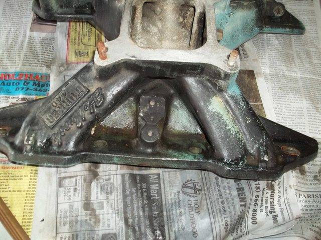

Here's some photos:
We've used Dawn and water, then Purple foaming something with Kabooom! oxiclean (which does a great job on the interior), and now I'm using oven cleaner - easy off .. full fume version. I'm in the garage and watching the ventilation with overhead and man door open and fan blowing.
Before (after cleaning with Dawn)

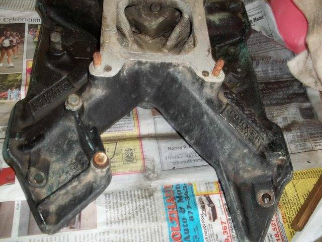

Other end after cleaning with oven cleaner, water rinse, then wire brush. I sprayed a test spot on and left it for about 10 min and this is what it looked like after. As you can see it used to be turquoise but i put in on my 70 which was Orange so I painted it black 30+ years ago.
I've been cleaning parts this weekend along with the help of my daughter, thank goodness for her help!. Late last night
Here's some from last night and the underside w/o oven off just dawn and water and then Kaboom oxiclean spray on foaming stuff. BTW it was never painted underneath. I used a razor scraper on the gasket surface.

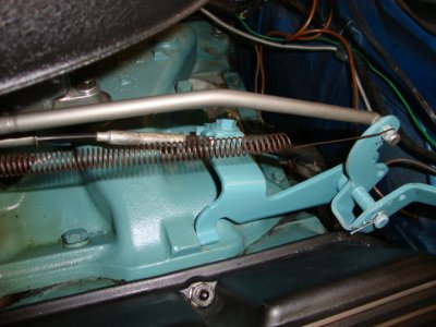

it looks good B. i found 68 turquoise paint from Mr MoPar parts http://www.mrmoparts.net/mopar-engine-paint-red-blue-orange-turquoise/ it matches pretty well to the other parts i have under the hood (taking in to account the other parts are a bit "seasoned") pic:
the part number is P4120752AB. he wants $16 a can plus shipping...i bought one with some other parts i got, and wound up buying 2 more cans just to have on hand. hope it helps!!

Anything that is caustic (sodium hydroxide) will attack the aluminum. The purple cleaner is on that list as well as oven cleaner. How you will know is when the aluminum starts to foam up and turn gray shortly after. These cleaners will remove grease pretty well but I wouldn't leave them on the aluminum too long. For old paint you might get away with using acetone or paint remover and a wire brush.
Thanks Meep. That's one of the reasons it took me so long as I was being really cautious and not doing large sections at once then scrubbing and dipping the wire brush (small one) in water as I worked the paint and grease loose. Then rinsed, then let dry then did another section. I think I was a little over cautious though. I did wash it down with dawn / water solution when done, then went out and hosed it down really good with the water hose.
