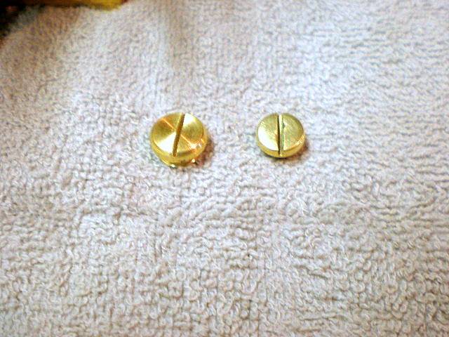

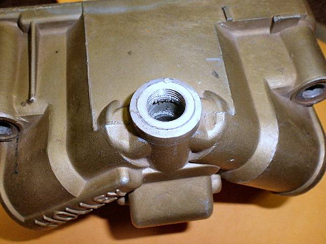

I have ran into a lot of stripped threads on Holley fuel bowl sight plug holes and needle/seat,made new sight plugs one size larger,new insert for needle/seat to save the bowl,you clear sight plugs could possibly be replaced.
I have ran into a lot of stripped threads on Holley fuel bowl sight plug holes,made new sight plugs one size larger to save the bowl,you clear ones could possibly be replaced.

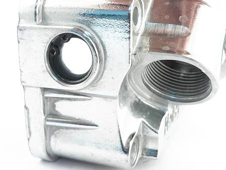

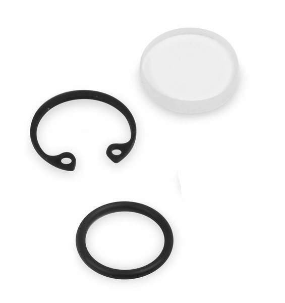

New style doesn't thread in...held in the hole with an E clip. I guess they work good, just a different design.
They are the style that quick fuel uses in their fuel bowls. The hole is bigger in the bowl compared to the little plug Holley uses.
