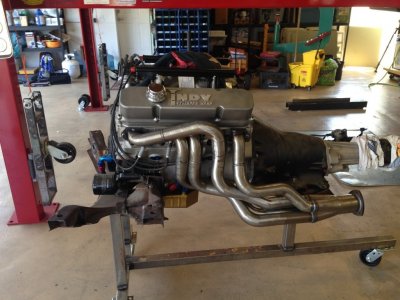

FYI fellas,
After test fitting my new TTI's on my Indy Max block engine I found they hit 3 maincap cross bolts. I called TTI tech and was told I could dent them in without damaging the coating. It worked! We used various rounded shaped metal pieces with an arbor press and with a large "C" clamp, cold. I would have been concerned about power loss but, after watching the Hot Rod header bashing video, that appears to be nothing to worry about!
I did use a tough plastic between the pressing tools and the ceramic though.
Mike

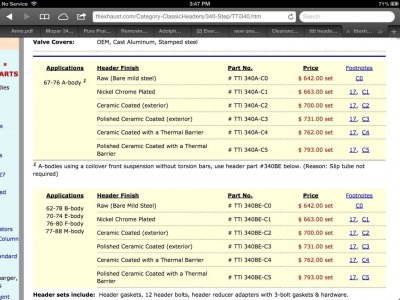

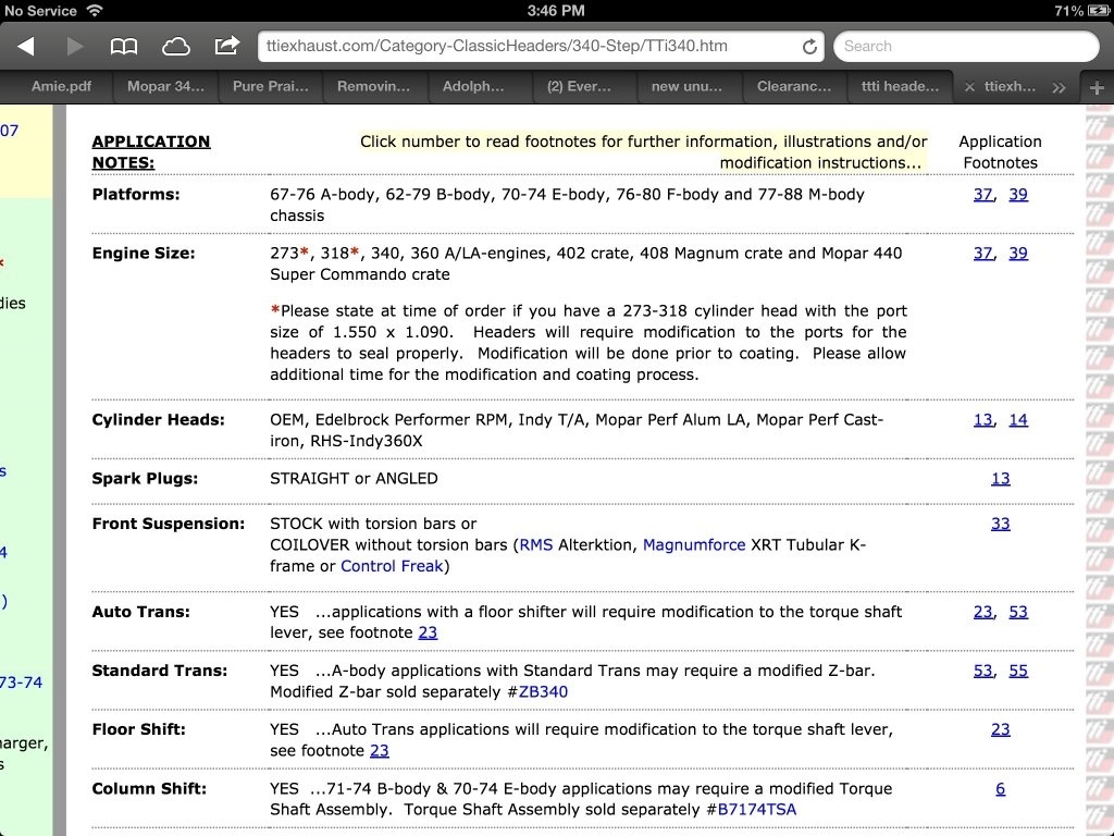

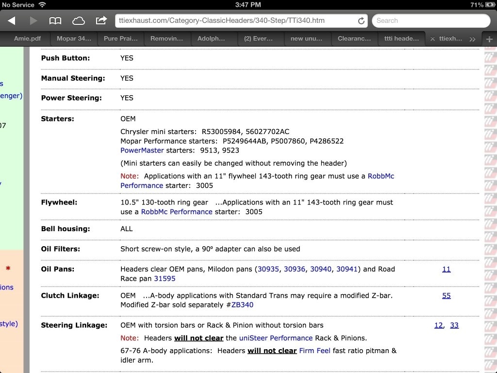

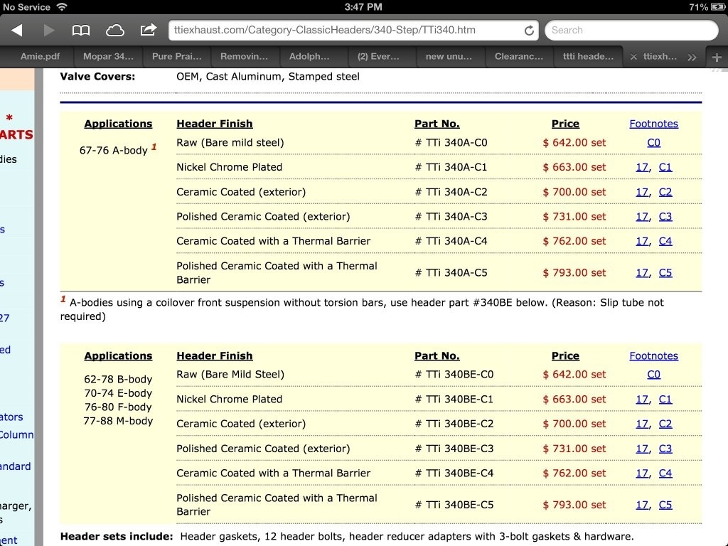

If they say anything of that sort, I would direct them to their own website. I see tons of aftermarket parts that these heads are supposed to fit ... but really don't. The following is for the SB step headers:

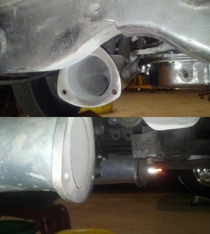

I have a 64 with a later year k-frame and TTI headers. Had a slight issue when I wanted to use collector extensions. The drivers side was slightly in line with the transmission mount. I guess it's common enough because others I talked to seem to already know about it. They all had the same advice so we took a long, very long pry bar inside the header collector and "coaxed" it down while bolted to the engine in place. Didn't break any welds or visually bend any tubes but I can't say I wasn't worried.
