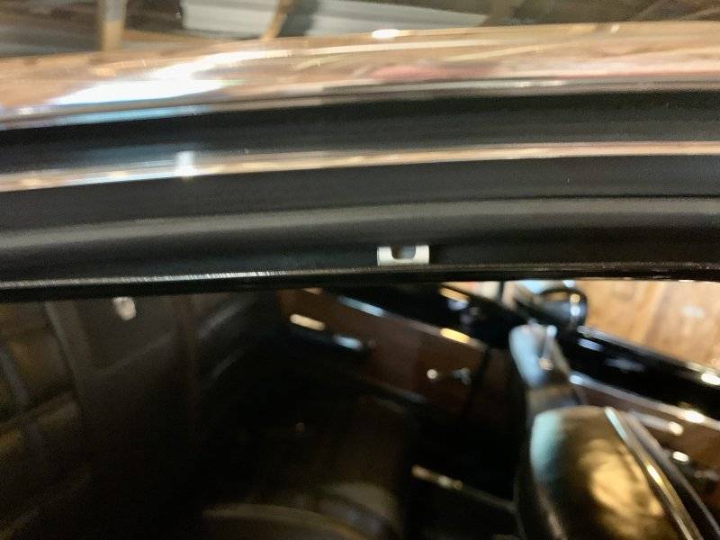

I noticed that this piece of trim on the inside passenger side of the GTX hangs down a little because the clips do not seem to be holding it into the place. My assumption is I can just replace these clips and snap it back up into place. Not sure what these clips or what the piece of trim is called in order to find the right clips. Also open to any thoughts on whether there might be a different problem here. Thanks.
The clips are in the picture below and are readily available at most Mopar restoration shops. The trim piece could be called headliner side trim. You should be able to remove what you have, crimp the clips a little tighter and re-install. I have found them not to hold as perfect as you would like, but they do work. Possibly fit the piece without clips, while off, to make sure it's not bent/warped which would haul one end down.
