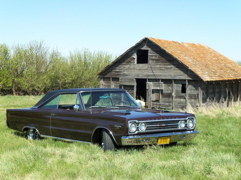

GOOD DAY .....FELLOW MOPAR OWNERS
I HAVE AN ISSUE THAT I NEED RESOLVED, OR AT LEAST AN IDEA OF WHAT TO EXPECT
WHEN I TAKE HER TO THE DOCTOR !!
MY 67 GTX HAS A" CLUNK " SOUND WHEN I START OUT..... DRIVING DOWN THE STREET.
IT SEEMS TO BE A CLUNK SOUND BETWEEN 1st AND 2nd GEARS......YET STANGELY ENOUGH
ONLY AT THAT SPEED (10-20 ) MYRA'S CAMERA 029 - Copy.jpgmph.
THERE ISN'T ANY ISSUES AT HI-WAY SPEED,I DONT THINK ITS THE TRANNY I FEEL ITS THE
REAR-END ! MAKING THE CLUNK-NOISE
THE POWERTRAIN IS ALL ORIGINAL TO THE CAR WITH 70 000 MILES. I DID REPLACE THE OIL IN THE REAREND AND THE
TRANSMISSION DO THESE OLD MOPARS HAVE A SLIGHT WHINE IN THE REAREND ?? .........SLIGHT !!
ANY HELP HERE IS APPRECIATED . I WILL HAVE TO TAKE IT IN TO A SPECIALIST
