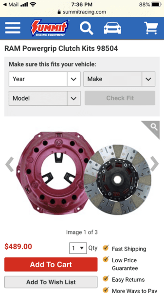

I have a 70 GTX with a 10.95 w/ 18 spline clutch. I'm in need of a new one and was wondering what every one is running in their cars. I also believe I need a flywheel because of it getting "glazed". I was going to go with a power ram power grip clutch system. What flywheel would go with this?

I am running a Mcleod Borg and Beck 3 finger pressure plate (360153), Mcleod disc (260151), Mcleod t.o bearing (16061), Mcleod flywheel, (464102). Mcleod does not sell Borg and Beck type anymore. Only diaphragm type. I had them rebuild my pressure plate. If you want a Bork and Beck type, go with Ram.

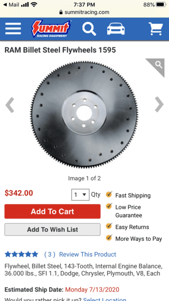

That is the setup I was looking at but I wasn’t sure about the eternal balancing as my car is a six bbl and it’s externally balanced
My car is a six pack car but is not the original motor. It is a internally balanced crank with non six pack rods. I’m also using the older cast iron bellhousing and 11” clutch.
Not sure what would be the correct flywheel for your engine would be. I’m sure a quick call to Ram or Brewers would clear things up.
Check out Brewers performance. They have a weight that you add to the McCloed flywheel for Six Pack applications.

How many teeth are on the flywheel ring gear, 130 or 143?
Ya I'm not sure about how many teeth are on it. Is there a way I could count a few in so many inches or do I need to count all of them
Seems if your pressure plate has 6 bolts holding it on, it's a matter of simple division, no?
Lol, l have no clue. If you told me what you are talking about I might be able to figure it out.
Thank you
Look at the PP in post 5.
6 bolt hold it on the flywheel.
130/6=? teeth between each bolt.
143/6=? teeth between each bolt.
Make sense?
