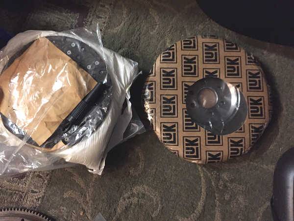

I just picked up a LUK flywheel/disc/pressure plate/tb combo. I’ll let you know once I get it installed and some time on it.

Good Luk! Yuck Yuck Yuck
Agreed, that would be penny wise and pound foolish !
