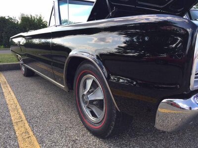

I bought a set of Coker radial red line tires through Jeg's 3 or 4 years ago and had them installed on my '67 R/T up here in Ontario. Towards the end of old car season in 2019, I noticed I was getting a shake in the steering wheel. In the spring of 2020, the shake was worse, so I took my car to local tire shop to get the front tires rebalanced. The technician showed me that my shake was due to belt separation on one of the tires. I don't think there are more than 6000 miles on the tire and it is junk. The tires are based on BFG Silvertown carcass. Has anyone else had problems with Coker Tires, or is this just my bad luck? Are they made to just look at on a Trailer Queen, or can a person actually use them as a regular tire?

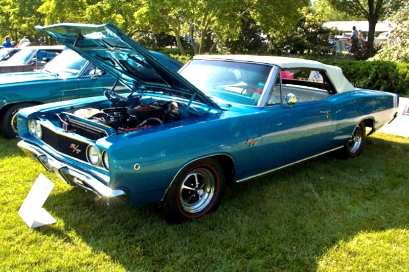

A very good friend of mine has a set on his 67 Coronet vert. Car has had a shake in it since day one. They are the BFG carcass tires
he put a set of Cokers on his 68 Coronet and no problems since day one ,,,sadly long longer being made
