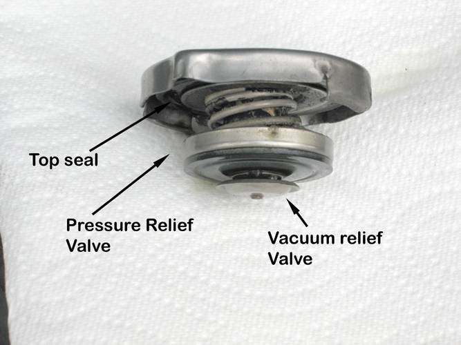

I believe this is a problem with the rad cap. Do you have an overflow tank/hose?
I'll second the cap. Unless you have a pressurized surge tank (doubtful) the cap should have a 2 way valve in it so that it can vent over pressure as well as compensate for contraction during cooling. I'd replace the cap.............. and maybe use a hose with an anti collapse spring in it.
I had this happen, but my issue was the tube to the overflow bottle was clogged. Cleared the tube, and done. But, the clog was just keeping the cap from doing it's job, so yeah it's the cap, or associated items.
Spring in hose is usually lower hose because of suction from water pump. Top hose is return to radiator to cool things a bit.
Yea it might be the cap, I will take a look at it.
Thanks
I had a 'restoration' cap do that before. Simply crack open the cap once it cools a bit and you'll hear the inrush of air and the hose will pop back into shape.
Yup, cap was the culprit. Put a new one on and it worked fine.
