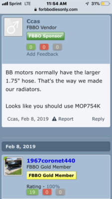

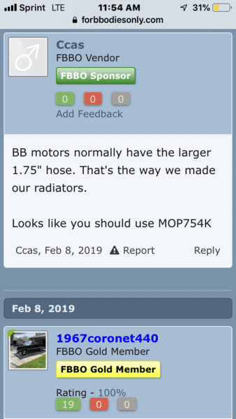

Got mine at 1.75” per their recommendation, interesting. @Ccas
Hmm I think there must be some typos on their website. Their website shows the MOP754K as having a lower size of 1.625".
Think I will give Ccas a shout to clear this up.
That is confusing! But so are most parts for Mopars! :BangHead: Give me a 1/2 day to do consult with our product manager and do some measurements. :)
Apparently our circle is slightly smaller. The raised bead makes up the difference and a 1.75" hose works fine.
