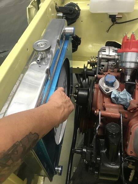

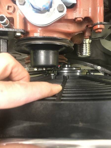

Just got this beautiful new radiator from cold case. I ordered an electric fan because I wanted to do away with the engine fan. Coordinated with them about which set up to use. actually through this site. Radiator is beautiful. looks great! however I go to put the fan shroud on with the electric fan and there is no way it is going to fit and not be jammed up against the water pump pulley. Am I missing something?
You have some serious gaposis from the rad to the core support, shouldn't the rad be sitting flush with it? That'd give you a bit of room? Can't help you much more, I'm sure cold case will help. Good Luck
You could probably find a brushless fan that protrudes less into the engine...measure 2x..cut once..ask for a refund on the fan.

Yep I had the same problem when I install my CC radiator. I went with a flex fan and shroud on my Bee. It was A pita had to buy a 1 inch spacer to make it fit.

It sure seems like you have the parts they suggest as fitting. Obviously they do not. A lower profile fan would possibly work. Mine is a 26 inch with dual fans and it fit fine. I did have to grind one fan a bit for my power steering pump snout. I can expect that as I have a non stock custom serpentine set up. Best to call them because no matter what they tell you they obviously have not fit one. I would prefer a puller vs a pusher for overall efficiency. Did the radiator bolt in place OK?
It sure seems like you have the parts they suggest as fitting. Obviously they do not. A lower profile fan would possibly work. Mine is a 26 inch with dual fans and it fit fine. I did have to grind one fan a bit for my power steering pump snout. I can expect that as I have a non stock custom serpentine set up. Best to call them because no matter what they tell you the obviously have not fit one. I would prefer a puller vs a pusher for overall efficiency. Did the radiator bolt in place OK?
I sent an email out to them. I tried calling but they were already closed. That’s another thing. Three of the four bolts fit on the radiator. The two upper bolts fit and only one of the lower ones fits. the fourth one on the bottom doesn’t fit. The groove/hole does not line up with the hole in the support. Another member on here mentioned it seemed like the radiator was sitting pretty far back from the radiator support. There’s probably an inch to inch and a half of space between the actual radiator and the radiator support. I think if the radiator sat flush with the support it would give me enough room for the fan.
your radiator should be tight or close to it ,to support,mine has about 1/4 gap.
