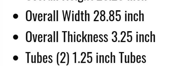

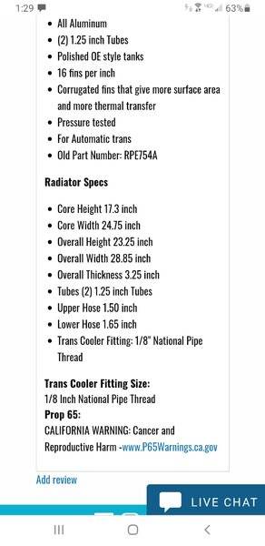

Here are the dimensions from the Cold Case website. It clearly shows the overall thickness is 3.25"
I agree with both sides to this. The listing isn't correct but also if the fan is going to touch it, having 1/4" clearance isn't enough either!
Cranky, look at the screenshot I posted. Unless Cold Case "just changed it" which I kind of doubt, it clearly shows 3.25"
