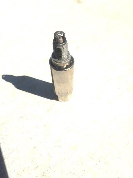

Well we took the car out to go for a hike and get some icecream with my wife today. It started cold ok with a little misfire, but starting up after driving to the park and downtown was bad. I had to pump the accelerator pump a lot and feather the throttle to get any cylinders firing after it sat for an hour at one place and I had to take the air cleaner off and feather the throttle by hand with my wife turning the key after sitting for half an hour at the other. This seemed like no cylinders were firing at first. I pulled a plug after getting home and it looks pretty good or even on the lean side compared to most times I pull a plug.
Well we took the car out to go for a hike and get some icecream with my wife today. It started cold ok with a little misfire, but starting up after driving to the park and downtown was bad. I had to pump the accelerator pump a lot and feather the throttle to get any cylinders firing after it sat for an hour at one place and I had to take the air cleaner off and feather the throttle by hand with my wife turning the key after sitting for half an hour at the other. This seemed like no cylinders were firing at first. I pulled a plug after getting home and it looks pretty good or even on the lean side compared to most times I pull a plug.View attachment 1096324
May want to try an old Champion spark plug.
I have a set of Autolite 65 I ran for 5 minutes before my brake booster sprang a leak and I had to pump the gas constantly to keep the engine running till I got home. Needles to say those were a little fouled, so I put the e3s back in. I have them cleaned up, so it's something I could try. Should I consider running a 66 (hotter) heat range instead?
