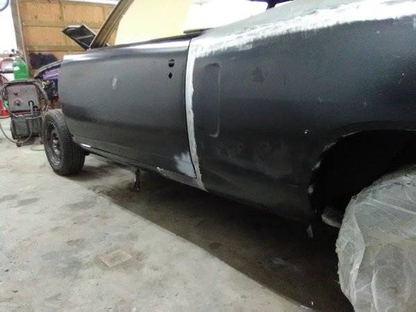

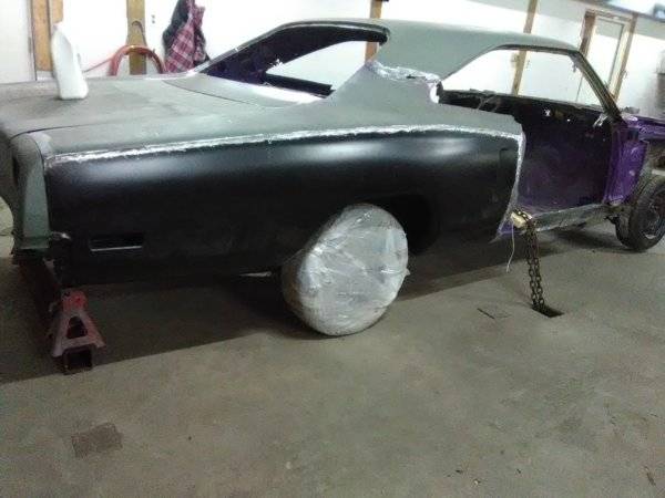

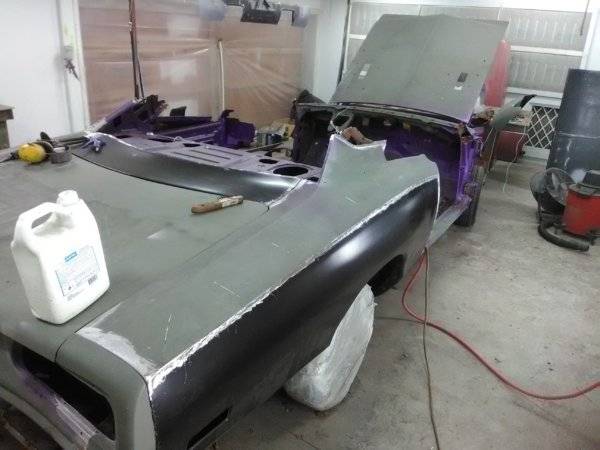

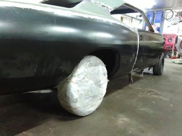

you can't be afraid to dive in....the best part about collision work is the car is already fucked up........ lol....... this one had the roof crushed down into the hinge pillars; making the doors stick up above the quarters about an inch......... inner and outer rockers were folded right behind the torsion bar member.
last week......
Sunday night......
tonight...........
last week......
Sunday night......
View attachment 573682 View attachment 573683
tonight...........
View attachment 573680 View attachment 573685 View attachment 573684
