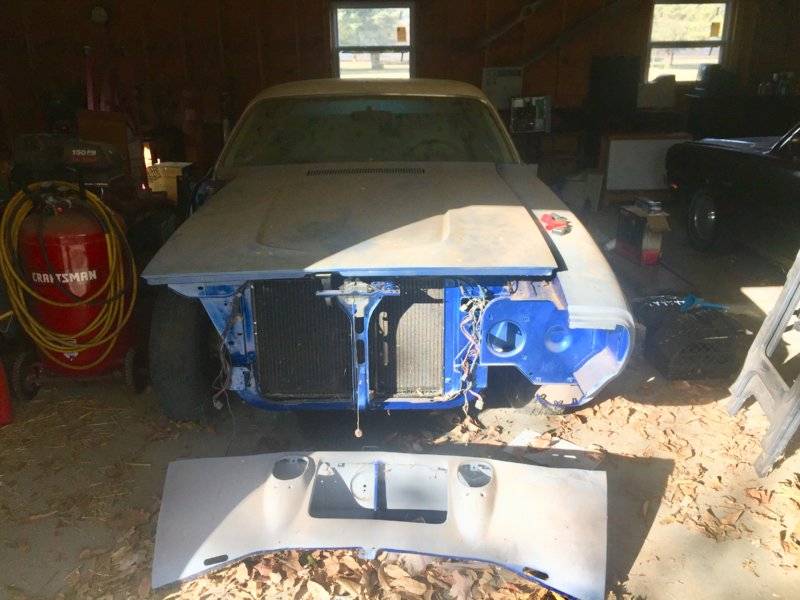

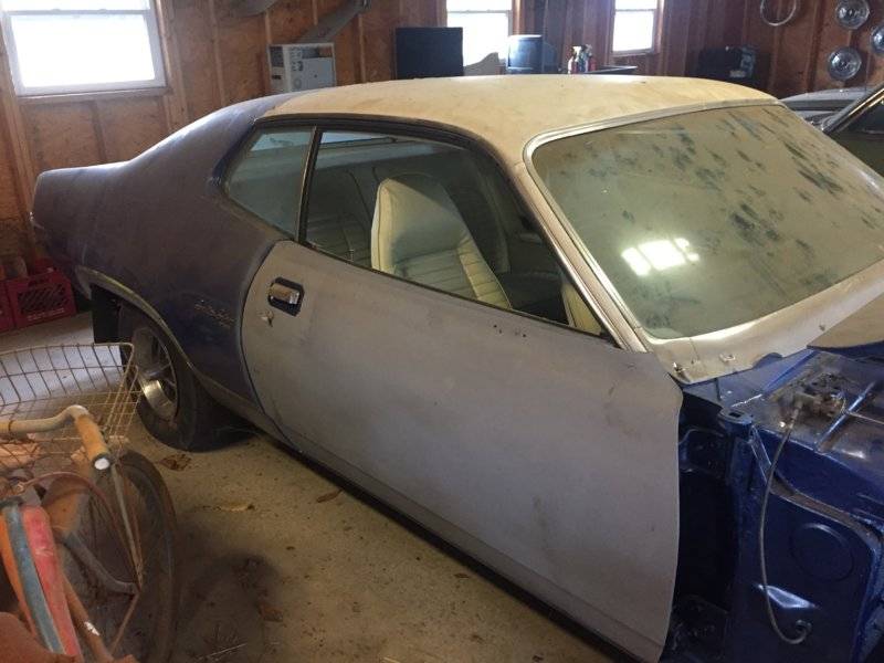

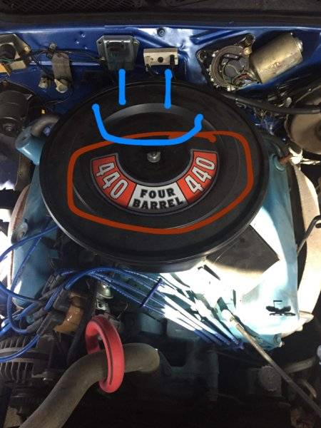

Also, what recommendations do y’all have for headers? Ceramic or non? Suppliers? Those exhaust manifolds are hot! Hope the pic upload works. A 440 is considered an economy engine today right? AKA: not a Hemi. Haha :)
5718C36D-15CA-4B0D-8618-076BA8772282.jpeg 4F38C3B9-0F3A-479E-B310-C3421569E52E.jpeg 7660A694-7A38-4390-B70D-89AAF7808A3F.jpeg
That is how the car has sat for 11yrs since my uncle past away. I had to replace the ICM and it fired back to life. The electric choke idles high in my opinion. Likely over 2500rmp. I’ve pulled out all the white interior to correct it to black. I’ve bought all the supplies to prep the vinyl for the black paint offered by year one. The white top will go to have the proper strobe bars.
