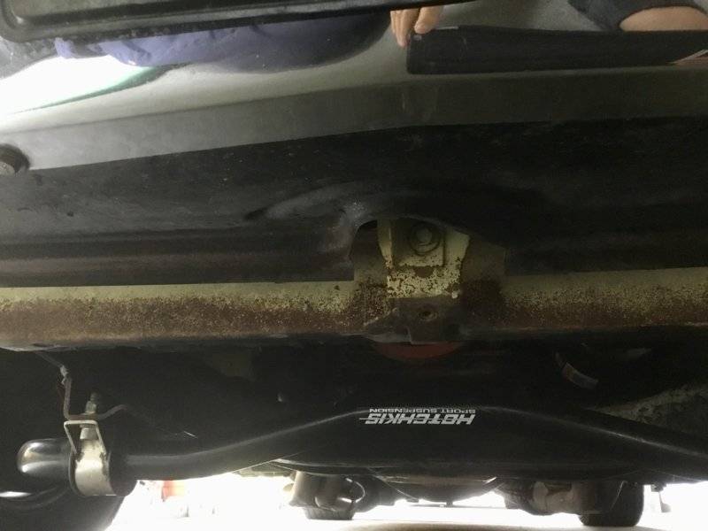

QA1 lowers do not have the Bump stops!! I drilled and installed new bump stops to the frame. PIA, but worth it!! I went with Hotchkis for everything else and a Borgenson box and a ultra light Jeep Pump..
@Derwud
I would have the suspension shop install the bump stops.

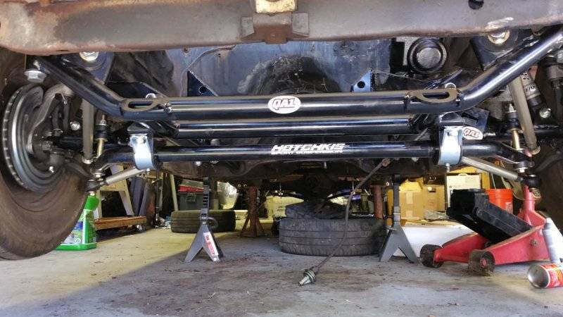

Don’t allow Brand stickers to be a guide when installing parts. That Zerk fitting was gone on day one. Man, it’s ugly down there. Glad it works better than it looks.
