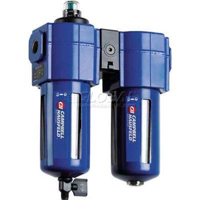

You should have on of these off the tank. Or something similar. . Drain the tank after a days use if theres alot of moisture.

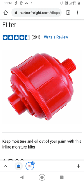

Get ahold of a new hose to use after your filter setup. Your old hose may be imbedded with contaminates. Also as a final ounce of protection, you can get filters that will screw onto your paint gun as a final bit of protection.
Do as suggested and also add one of these to your gun as a last line of defense... cheap insurance.

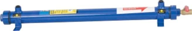

Use a couple of the toilet paper type filters ( made by Motor Guard) in the hose line ie. hose connected to outlet after drip-leg, TP filter and hose connected to filter then hose to gun. Be sure to use the gun pre-filter as suggested above, get a couple of good quality ones (they are cheap)and change them regularly ( 2 or 3 for a complete paint job including clear coat.) Make sure your drip leg is long enough to catch all the condensate, if your compressor has the capacity consider leaving the drain valve on the drip-leg very slightly cracked oven. I have built a poor mans refrigerated dryer set-up using a large ice chest and a roll of copper tubing, fill the chest with ice, this helps the moisture to condense and makes the drip-leg more efficient (I only do this for paint jobs) . I have mine on a shelf above the drip-leg. I plumbed it immediately after the compressor and before the drip leg. Consider painting at night or very early AM if temp/humidity are concerns.

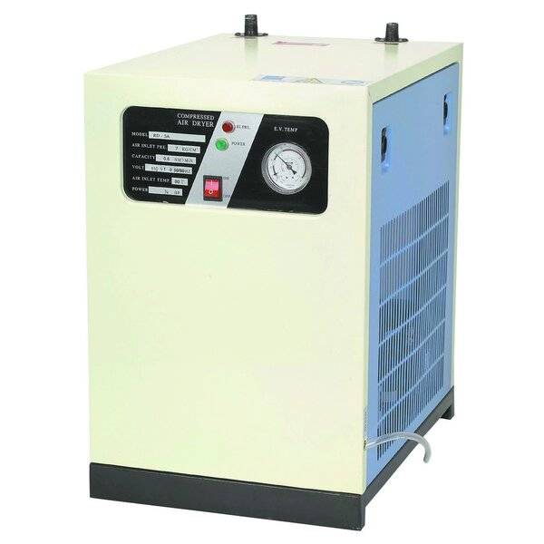

Any serious shop will have a dryer. Nothing more than a refrigerator with a separator afterwards. On a budget it’s super easy to coil a 50’ length of hose in a joint compound bucket full of ice water. This will condense the moisture and let the separators work. Have fun! I’ve done about 13 garage paint jobs and all have been good.
Harbor Freight has a refrigerated dryer for a reasonable price. If you are going to do
a complete in your garage, you shouldn't be worried about the quality of your supply air!
