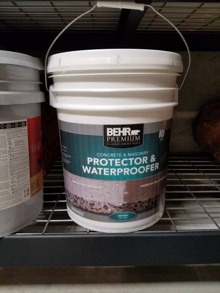

I've used many different types on many different houses in my life time. This I put down last year and the water still beads up and never penetrates the concrete.
