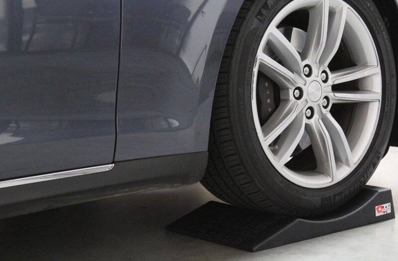

I was always told to use tire savers like the ones pictured. You can just google tire savers and you'll get a bunch of leads...

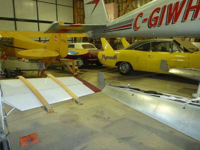

Both cars almost 15 years in one spot.... had no issues running the track at Atlanta and a lot of other driving the past 2 years on the Polyglass tires I bought in 1990. The 'vettes Michelin radials on the other hand were toast..

My BFG comp TA’s on my wife’s SRT will flat spot all the time, takes a little drive time to shake it, I’ve tried the over inflated trick it didn’t help.. Good Luck on this one! The ramp that you drive on looks interesting like it may work.
