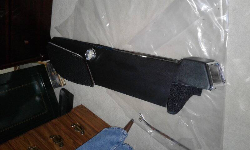

What is the best adhesive to use to attach the console carpet pieces? The trim adhesive I used is not working. The carpet peels right off.
Also, are the side carpet pieces held by the stainless trim pieces or do they just butt up against them?

The side carpet goes under the trim. And it is also glued on.

The factory carpet on my console was notched for the side trim clips. Trim goes on after the carpet for sure. Get a good glue - 3M Super 77, Armaflex, or similar.
I guess you wouldn’t have a picture of the notches? My carpet pieces will need some slight trimming to align perfectly with the trim pieces.
