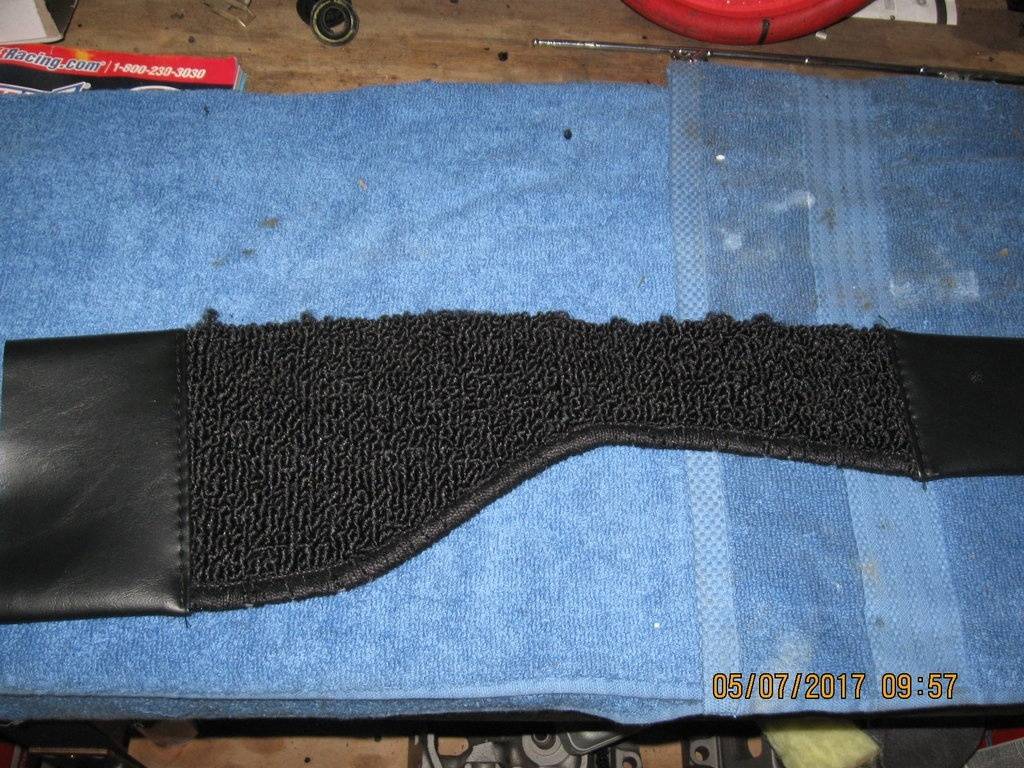

do anyone know how to install this piece at the bottom end of console
see pic.thanks
Glue carpet portion to rear console metal frame piece...the vinyl end wrap around the inside edges and glued. Then punch a hole through the vinyl and screw hole in metal frame and attach to console.
thank you very much justin.
