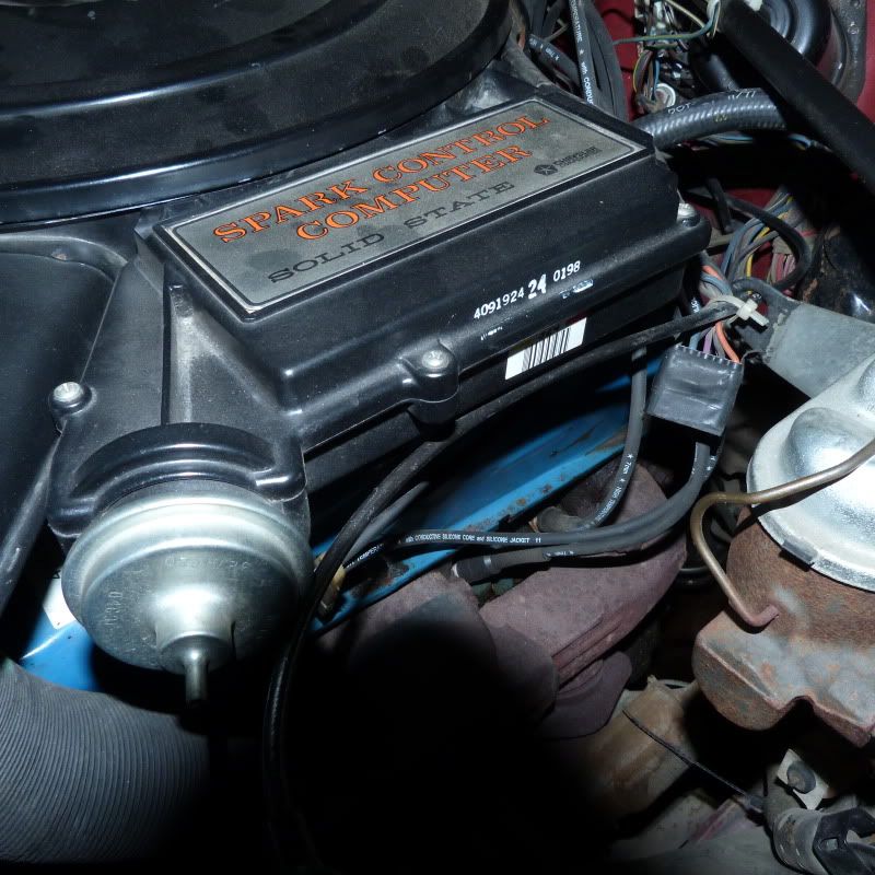

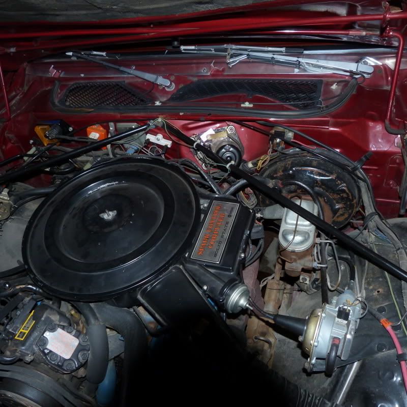

I'll get some pictures for you tonight, don't know much about wiring/electronics so I won't really be able to explain the setup very good, sorry. I was told by someone looking at the motor that it had been done though so next time I see him i'll get a better description for you. The computer box is still mounted on the air cleaner.

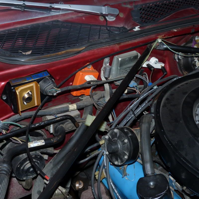

Not sure if these pictures are of any use to you, I will get some better ones with the air cleaner off when I have time.
I think your engine was converted to a Mopar electronic system. Today I tested my car on the road and the cruise control worked fine. I know the A/C is out due to lack of refrigerant, I think they were still using R12 in 77. I've had a couple cars converted to R134a with no problems so eventually I will have that done with this car. The only electrical connection I see is some sort of sensor or compensator for the increase load the A/C compressor puts on the engine, it would appear to increase the idle to prevent stalling. I've dealt with that problem on other cars as well.
