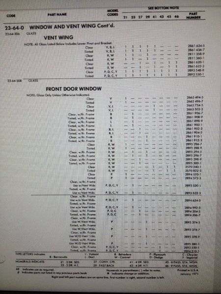

looking to purchase a driver’s door glass for a 69 convertible. Clear, non tinted.
I'm no an expert but isn't 2dht door glass the same?
Just looked in my 66 parts manual front door side glass, the 2 dht glass is the same in 66 so maybe they are the same in 69. d
Don't see why not. Of course quarter glass is different. 66 front door window glass p/n is 2570790-1 that 790 I assume 790 is right and 791 is left.
Geez, I'm not positive, but I believe ALL the glass on a 68-70 b-body convertible is different than hardtops/coupes. The windshield is the same as a 66-67 & the vent window seals are 66-67 (likely the vent window itself is 66-67)….but I "think" the door glass is unique in some way
Auto city glass has it. I used it in our 69.
I had looked at auto city. How did the new glass from them fit up? I’ve read a lot of bad reviews on the new side glass for these cars
Convertible window glass on 68-70 b body will not fit anything else. Roof line is slanted.
The glass is different, our Auto City Glass fit pretty good.
