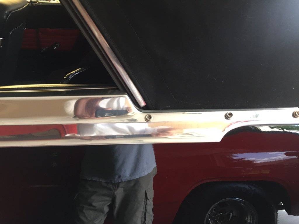

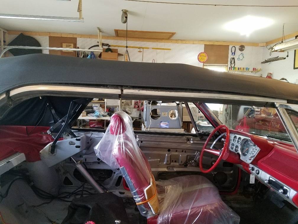

Seems that few things have gone without a hitch on my Fury restoration! Latest is the new top installation by a top shop that's been in biz for 30 years and came recommended. The top doesn't appear to fit properly at all. The top guy said "older Chrysler tops are a nightmare to work on". Wish he would have just said he couldn't do it and find another place after keeping my car a week. I'm posting a couple photos wondering if fellow members have encountered a problem like this on their earlier B-Bodies or if I'm making too much of a deal on what is supposed to be right. In the 1st photo the top bows upward over the top window line exposing a lot of the sub-channel and it's easy just to reach in under with the hand to inside. My guess is the top will rise up at faster speeds exposing to outside. The 2nd photo shows a gaping holes to the inside or out behind the rear windows. Nothing to enclose this area from the elements. It seems that the top isn't wide or long enough.
Any comments advice is appreciated!

Well Ron, I put my own top on my '70 and I believe they're pretty similar to your '63 (I "think").
For your 1st picture with the top sitting up too high on the bows, on my '70, each bow has an up/down adjustment. It's a stud/nut sitting inside an oval hole so you can raise/lower the bows about 1".
For your 2nd picture, it "looks" like the top is not positioned correctly and should be pulled forward in that section, just like it looks to your eye.
At least on my '70, the reason it's a PIA to work on is the design of how the top attaches in the back/boot well area/rear window. On Chevy's (sorry to use bad language on this site), the there are what's called "tacking strips" inside the that rear area of the boot well. You just lay the top down along it & staple the top material to those strips...easy-peasy. For Mopars, the "tacking strips" aren't built in to the body, they're separate pieces that bolt in & the top staples to the BODY SIDE of those strips. You have to lay the top in that area, partially install the tacking strips, use a grease pencil to mark where the top goes in relation to the tacking strip, take everything back off, staple the top to the strips (basically to the back side of the strip) and then bolt the strips back in place. At least when I did it, I had to take the strips off, adjust, re-staple & repeat several times. If you're not concerned about it being original, you could install "GM-style" tacking strips on the body itself and do it the GM-way.
As far as the top "settling in", what I was told is that tops shrink in the sun, so if it's a little bit "loose" and/or has a couple "minor" wrinkles, they'll shrink a little bit and fit snug. Your top already looks too tight, not too loose.

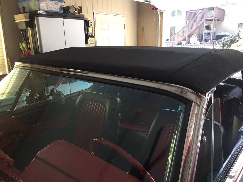

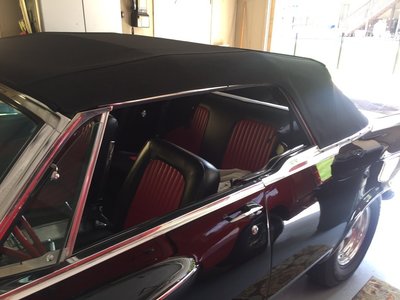

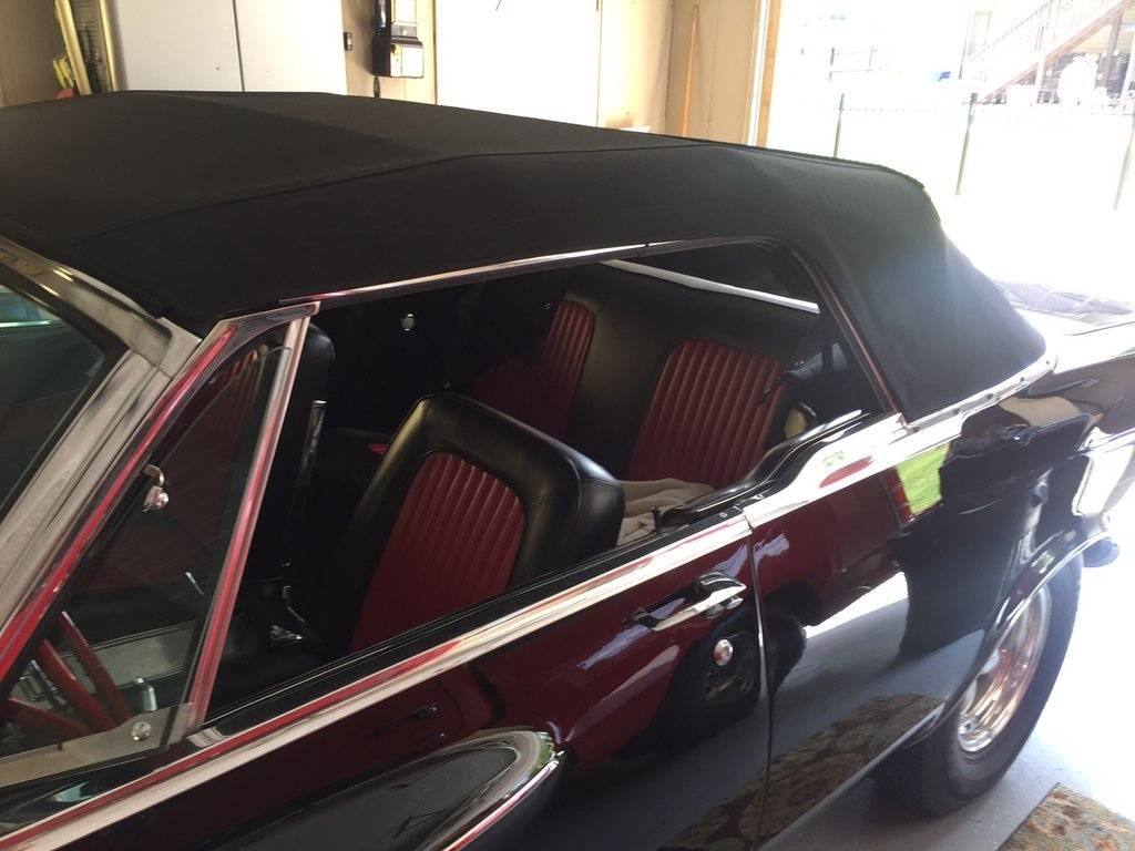

My top was done by Dave up there in Bristol, WI when I lived there. His business is known as
"Vintage Stitch". He does outstanding work. Dave's email [email protected] Here are a couple of pictures of my top. I was VERY happy with his work. I went with a canvas top simply because I like the look. In your case it looks like the top is simply too small. If the installer provided the top and it doesn't fit it's his problem. By the way, your post says '63 but the dash is '62? If you speak with Dave tell him Rick with the black '62 Sport Fury sent you his way. He also did my interior. If you have more questions feel free to PM me.

I see the bow adjustment is already set down as far as it can go and top is stretched tightly over the bows making them more noticeable. My concern as Rick62 stated is the top just looks too small or just installed incorrectly. The guy ordered the top and assume it was for the car; I'll have to call him again on this. Rick62 your top looks great nice to know somebody out there knows what they're doing. PurpleBeeper I wonder if a shop could redo this top or if it's a matter of a new one put on by someone who can do it. The entire area around the rear looks stretched as far as it can go so moving it forward looks like a no go as it's trimmed right to the edge of the hold down strips maybe there was more material that he cut off rather than move it ahead or see he should have done more repositioning before he cut it. Photo shows this area at rear window. I suppose take it to a shop to see if it can be readjusted or have to have it redone...(I installed a 62 dash as I like the looks of that dash more than the ranch gauges 63's had).

Well, if he already trimmed the top right at the tacking strips, then there's probably no way to adjust it. I mean, you'd have to pull it "up & forward" from those rear tacking strips, but then you wouldn't have any material left to re-staple. I left mine with about 2" extra cloth sticking out "just in case".
That would have been a great thing to do (leaving the excess) for checking if further positioning was necessary or after doing a re-check before calling it a job done, especially by a professional huh? He was given the outer trim to check how that would appear...how much more obvious could those large gaps behind the rear windows be as I posted? My only hope is if there are any other linkage adjustments possible besides the adjustable bow mentioned that's already set to its lowest setting. And I've also found I can't put the outer chrome trim on if I wanted to now as the screw holes are out of alignment. The under trim gets the slotted holes while the outer doesn't at least as installed so zero margin for error to replace the outer trim where it needs to be...

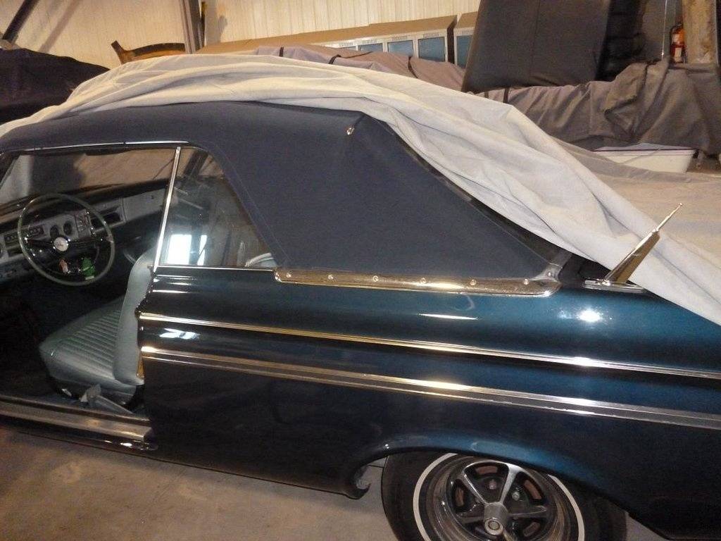

That's great news! lets hope he installs a new top! I have the same concerns on the area over the windows.Its been 10 years now since it was replaced and I'm happy with how it looks!
