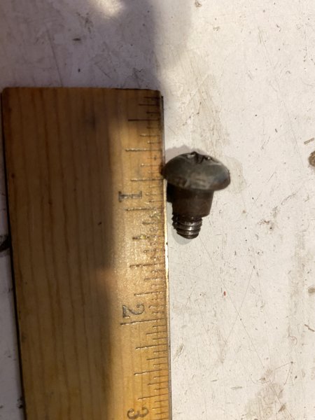

One of my screws is long gone. 63 SF convertible. The teinsioning wires hook on here, and there is a shoulder on the screw so that the end loops can rotate freely. See photo. Anyone know of a source? Thanks.
Unless you can find the correct OEM screw in used condition, you may need to make due with something newly made.
I have used short lengths of copper (or steel) tubing placed onto newer screws/bolts to provide the smooth shoulder shown by your image.
