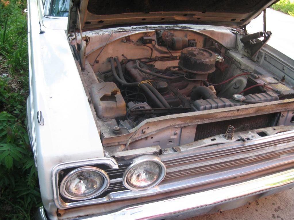

I plan on getting rid of all the AC stuff on my 67 belvedere and want to convert it to just heat. Does anyone know the difference between a 67 and 69 heater box? Are they the same or significantly different? I have a couple of the 69 ones laying around and it would be nice if that would work.

I don't ever plan on putting this thing back to an AC car. I have a donor 69 non AC firewall that I plan on patching the 67 with. I only want the option of heat when weather gets cooler up here.
The car is a clean 67 four door belvedere from down south. I plan on putting a 512 stroker with a 4 speed and 391's out back, tie the frame, relocate the springs and widen the wheel tubs to get some decent tires under it. I even plan on running the original hubcaps on it so that it looks like a granny car from a side profile. Just a fun sleeper.
